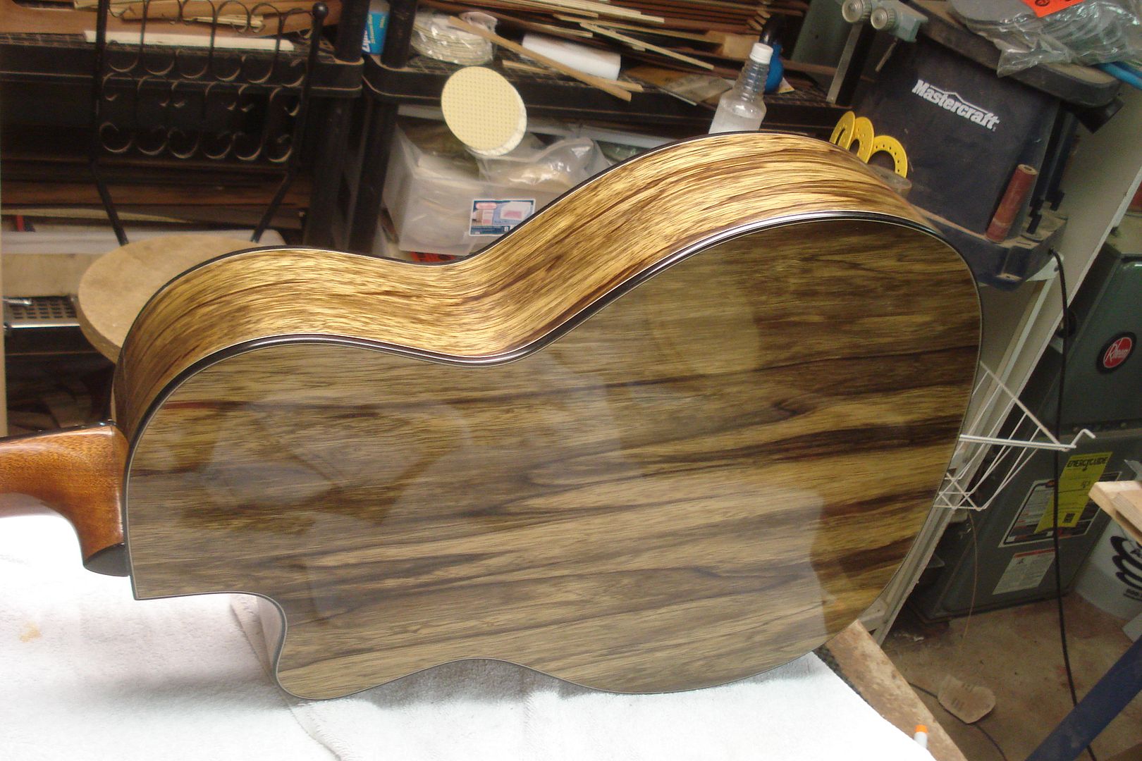

Lee, Colin and Brian:
Nice guitars, fellas. VERY nice!
Patrick
PostPosted: Sat Sep 27, 2014 6:48 pm
Wow 3 beautiful black limba guitars.
I agree! Quite lovely!

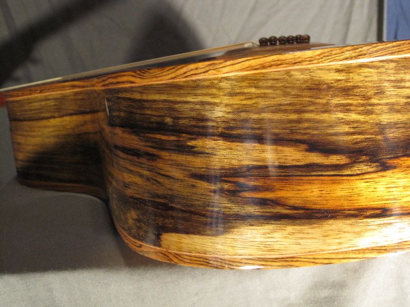

Awesome wood to work with, bends easy and sands and finishes to a beautiful look.
My result
Fred
Fred Tellier
