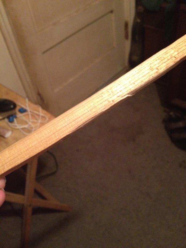

I used flat sawn brace wood my first time and didn't even know it until a fellow OLF'r pointed it out to me. I myself had ordered a plank of western red cedar from a lumber place not knowing that it wasn't quarter sawn or really that I needed it. I was told to take my wood and cut it the other way which I did and let me tell you, if it ain't truly quarter sawn wood it's not truly gonna work. It held and the guitar sounded great but when I eventually scrapped it for parts, I started just tapping it hard with a hammer and every brace sheared and fell off. Not only that but there was a visible radius to the bottom and top of each brace that I didn't put there. I do flats. Any way I'm glad I scrapped instead of giving it away I would have hated for someone to hurt them self if it ever catastrophically failed. Which it eventually would have done.
Here's a pic I hope of one of the back braces I saved as a reminder. This is what happens using non QS lumber.

Ya know, adherence issues crossed my mind, but honestly, I can't understand why it would be an issue. It's not like you were trying to glue to end grain. I'm thinking something else was going on like poor (new) technique etc. I think the real issue is being able to shape it. Plus it looks odd. :)

Western red cedar works good for soundboards, not so much for flatsawn braces. It splits along the grain more easily than spruce. Redwood is another one I would not use for braces. Looks like the brace itself split - gluing technique wouldn't help that.
