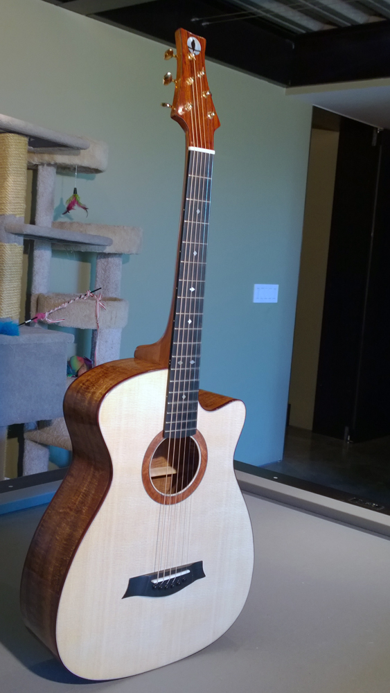

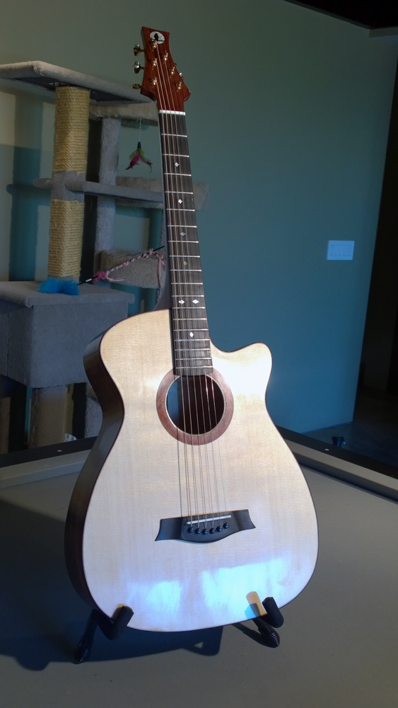

Well I still have some set up work to do. But I like to wait a couple of days to dial it in. I will get a video upbut wow it is loud, wonderful sounding treble strings right to the highest note, deep base. Pretty even tone across the strings. This is the first time stringing the guitar. The saddle and nut are close enough that the guitar is playable. I will do a real setup later in the week.
Designed using Medium Size SS Guitar plans and instructions from Gore\Gilet Contemporary Acoustic Guitar Design and Build books.
Lutz Spruce top
Australian Blackwood Back
Hawaiian Koa Sides
Cocobolo bindings and headstock veneer
Claro Walnut rossette
Walnut bridge ebonized with vinegar\Steel wool solution
Ebony Fretboard
Carbon Fiber falcate bracing
Built to have a live back.
Body Finished with Zpoxy pore fill, shellac wash coat, and EM6000.
Neck was French Polished

John, that looks great. Did you laminate the bridge with CF? I did on mine and then, without thinking, I tossed it in the microwave for a few seconds to heat it up before gluing it down - not a good idea :oops:

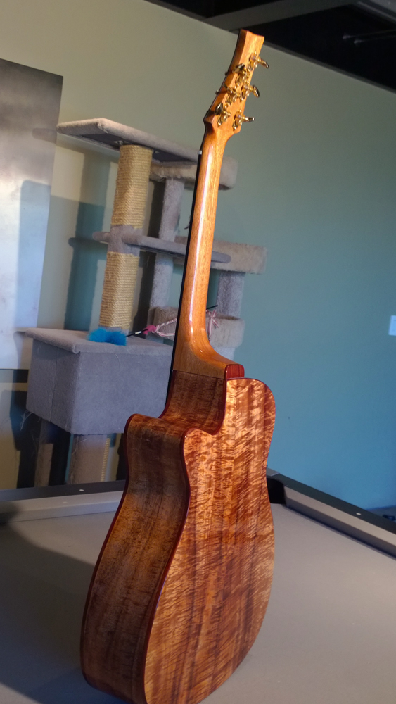

Very Nice -- the design has got some mojo!!! My only suggestion would be to opt for a more delicate contour in the neck/heel transition.
Thank you Toonces, I have thought the same thing and not sure how to go about fixing it as it looks blocky to me. I usually use a classical heel but I wanted the straight transition into the cut-away. I considered lowering the profile or rounding the heel more. I would take any advice and my even take it as the neck is only FP, I could change it and be on my way in no time.

I've sent you an email that may give you some pointers if you are wanting a more delicate transition at the heel.
PostPosted: Mon Jul 07, 2014 10:35 pm
Posts: 3005
Great job john, looking forward to hearing a sound clip. My comments are align with Toonces, you can safely remove a lot of material from the heel. You might search on some archtop images as they typically have heels that transition into the cutaway section. It's also possible to make the heel too thin and also doesn't look so good IMO.
Once again, nice job !

I personally don't have a problem with the neck/heel transition. I like cutaways but have always thought that the cutaway/heel section looked a bit clunky but that is just how they are. The one thing that I find a bit distracting though is the offset tuning pegs but that is just me. I have never been crazy about non-symmetrical headstocks unless they are 6 on a side.

Thank you James, The guitar is sounding great, very well balanced, clean separation of notes, a strum or a pick of a note sustains for a long time. The video is coming, believe it or not I have been looking for my camera that does good videos all day. All of the pictures I have posted so far are from my phone.
I followed all of the equations for both the top and the back. I very closely followed the plan for the top and the back as well. My final tap spectrum all strung up was helmholtz 92 Hz, Top 172 Hz and back 214 Hz.
