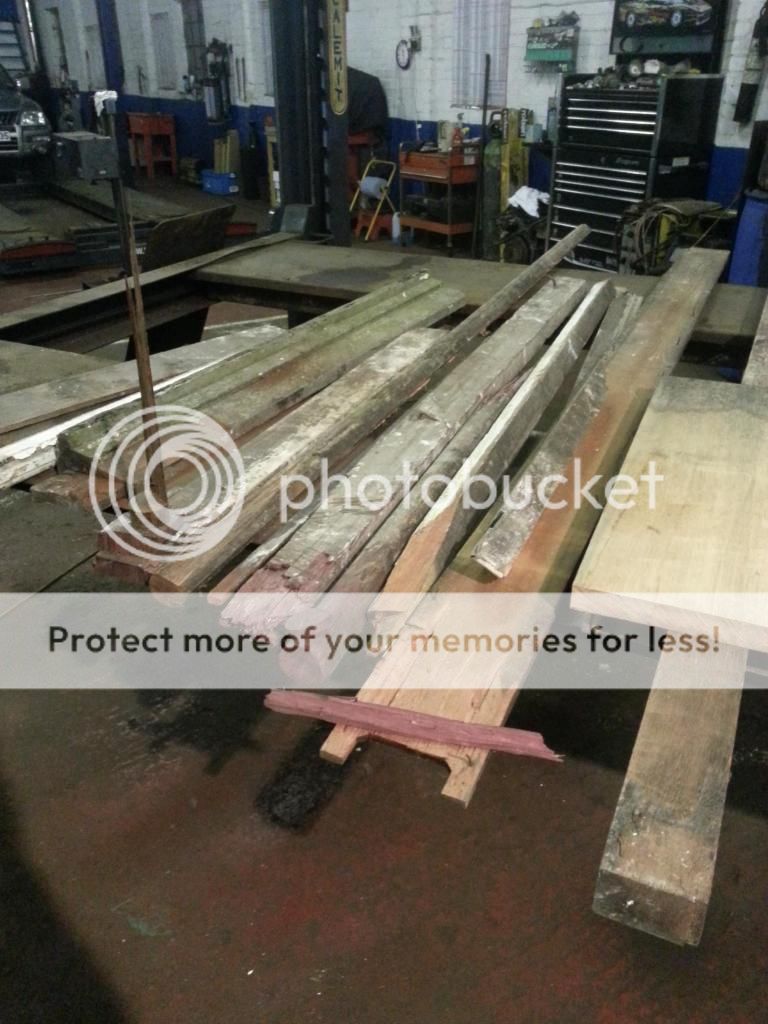

Hi all. I have just got hold of a bunch of reclaimed timber. It is window frame wood from a fancy old hotel that was demolished close to my home. The hotel was built in the woods around 1880 so the timber is atleast 135 years old. After cutting the end off a few pieces I think I have oak, mahogany, teak and something purple in 6-10 foot lengths. Some pieces are better than others but there is lots that looks in very good condition which I can use hopefully.
My first question is about the purple. The only thing that looks similar is purple heart. Some lengths have more of a browny purple tone and others are bright like the piece in the pic, weighs about the same as a medium to heavy mahogany. The thing is I would be surprised if there was much purple heart lying around scotland in 1880.. So is this some other wood??
my second question is about the strength of old wood. Can I use this for a neck or would I be better perhaps using it for inlays and sandwiched pieces to add colour?
I will start running them through the saw tomorrow and see exactly what I have but the purple bits have been a lucky find I think :-)

Cool thanks, purple heart is what it'll be then. Got enough for around 15-20 necks in the purple I think.
Is it a suibtable neck material tho?

It was called the greenmount hotel and it was a very expensive. Sat at the top of the hill looking over the forth estuary toward Edinburgh. From what info I have found it was built with no expense spared and was like 5 star back in the day. A fire took out half the building in the 1980s and it was left derelict.
Its definitely purple heart, I Cut some up and geez thjs stuff is hard! Its kept its colour internally and only turned a dark brown on the outside. Looks like it was varnish to start then it was painted white about fifty times lol. All that paint has sealed in the flavour I guess lol.
Fretboards are a great idea btw, it seems very similar in properties to ebony but the allergic reaction thing will need some more investigation though. Thanks for all the info guys ;-)
