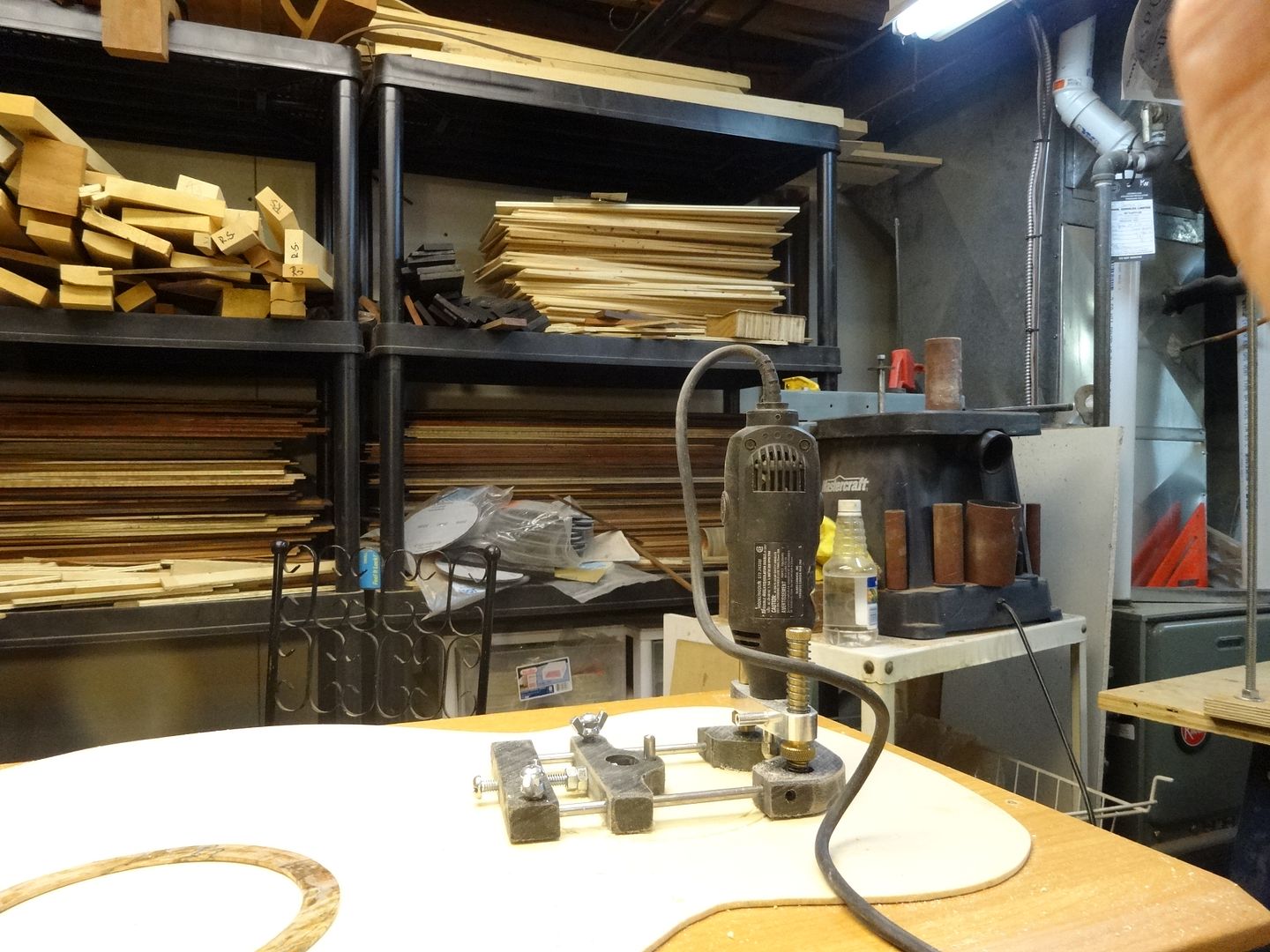

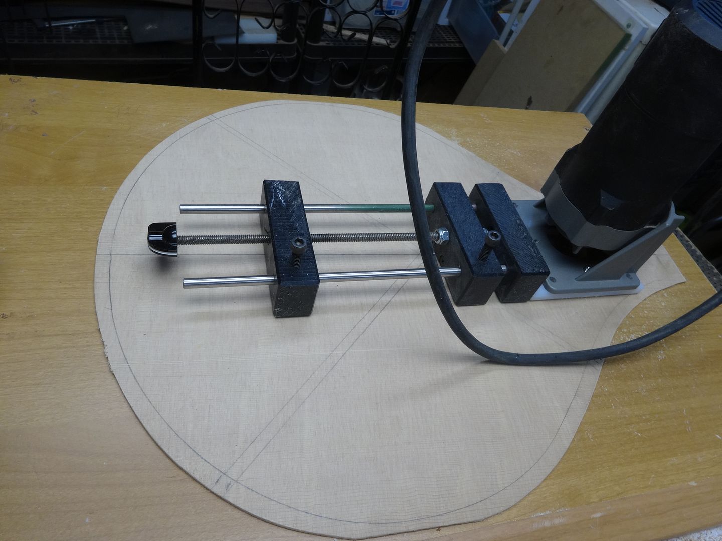

I picked up a Well's/Karol jig from Tony Karol at the Luthier day at Exotic woods last year the replace the one I made for my Dremel as a adaptation for my Stewmac base. All I can say is trim routers are much better than a dremel for cutting the rosette channels. Tony's unit is a bit rough compared to the commercial units but works flawlessly.
Dremel style circle cutter
Tony Karol jig
Fred
