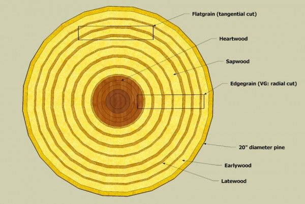

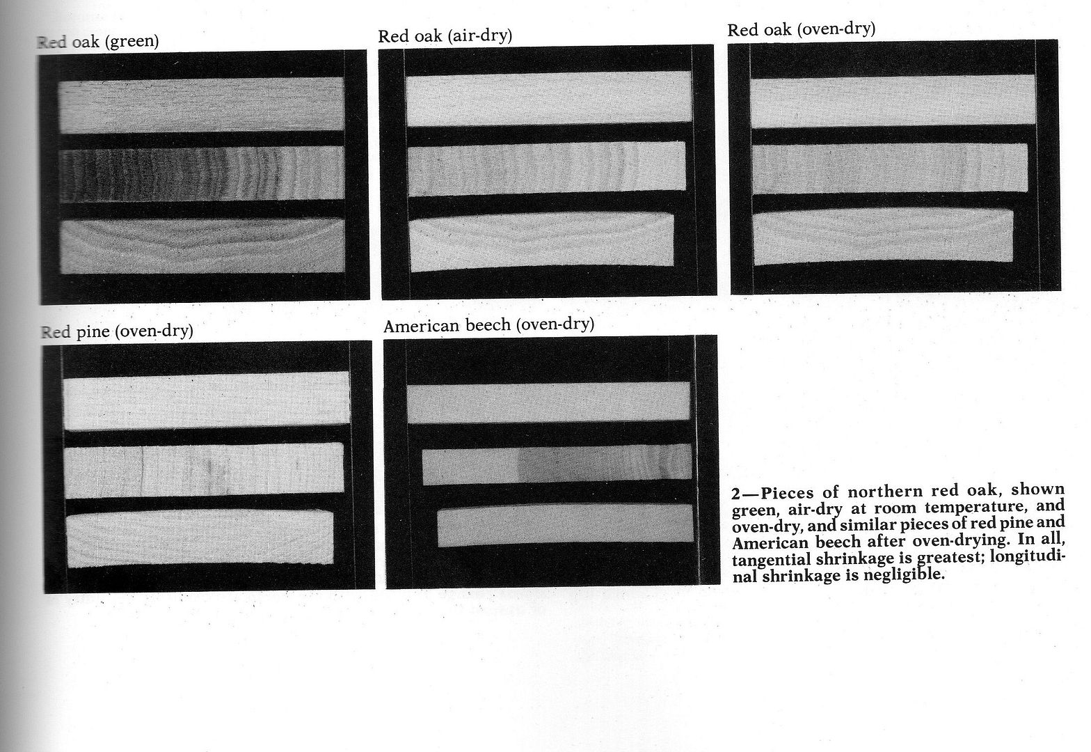

Seem that this author views it differently
http://alterra-wv.com/wood/quartersaw.htm
Also on page 75 in Bruce Hoadley's book "Understanding Wood" thought to be the bible on the subject by many including me, has photo comparison showing shrinkage differentials in different directions. The slab/flat cut shrinks far more longitudinally (across the width) than the vertical grain material (cut from 1/4 sawn lumber). And the slab/flat cups a great deal.
Ken Cierp
I'm not sure how any of that disagrees with what I said unless you weren't responding to my post. I know a lot of confusion on this subject arises from misunderstood terminology... when most luthiers use the term 'quartersawn' what they really mean is 'vertical grain' and when they say 'flatsawn' they really mean 'horizontal grain'. 'x'-sawn refers to how the log was cut, not the grain orientation. This is what I believe most luthiers mean when they talk about the different grain orientations:
It would be nice if luthiers could all agree to use a set of more descriptive, technical terms, but alas for whatever reason very few ever seem to. I think we can all agree that the big takeaway is to understand that quartersawn/vertical grain wood will move about ***edit: half as much with changes in humidity across the grain as flatsawn/horizontal grain wood, and that there are implications to this for every piece of the guitar, fretboard included.

PostPosted: Wed May 21, 2014 4:13 pm
Posts: 1737
Location: Litchfield MI
Vertical grain in the middle -- flat/slab on the bottom -- From Hoadley
All flat sawn samples show more shrinkage as oriented on the width of a guitar neck
Ken Cierp
