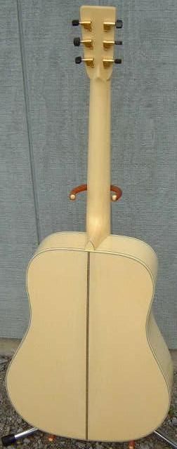

Ted Davis built a holly guitar. I never got a chance to play it, and I don't know where it is today.
He did give me a back and side set, presumably from the same wood that this dreadnought was made from.

John that is so cool!! Do you recall if the material was 1/4 sawn? I can get some wide Holly but have no idea how it was boarded out.
Very nice. At least he didn't cover it up with two tons of shell...
