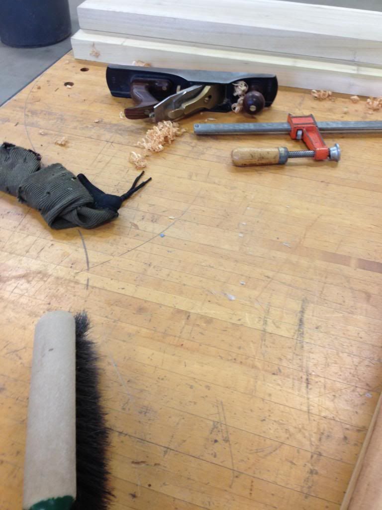

Image Lets get Planin!

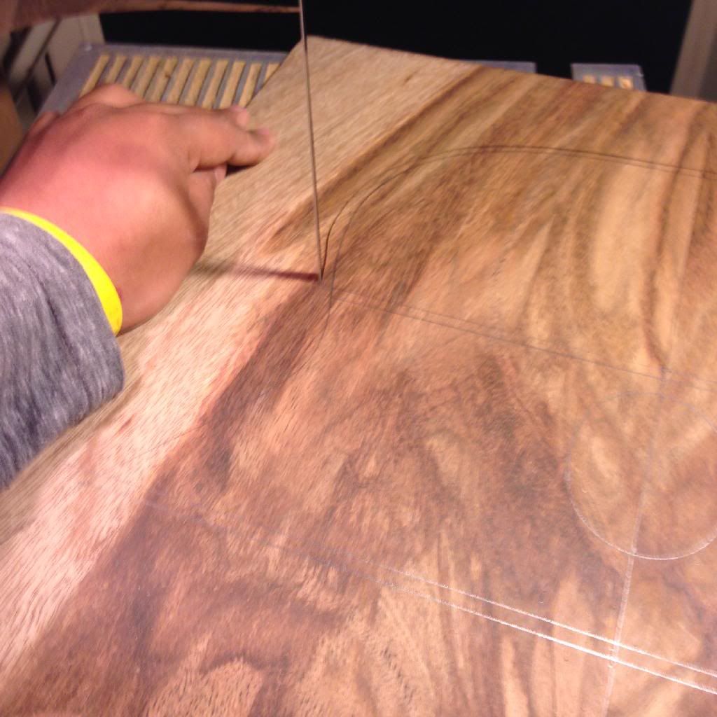

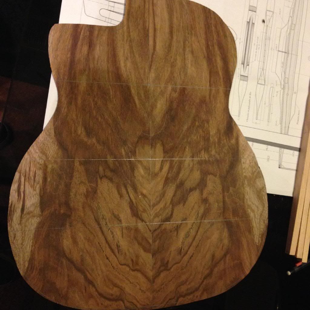

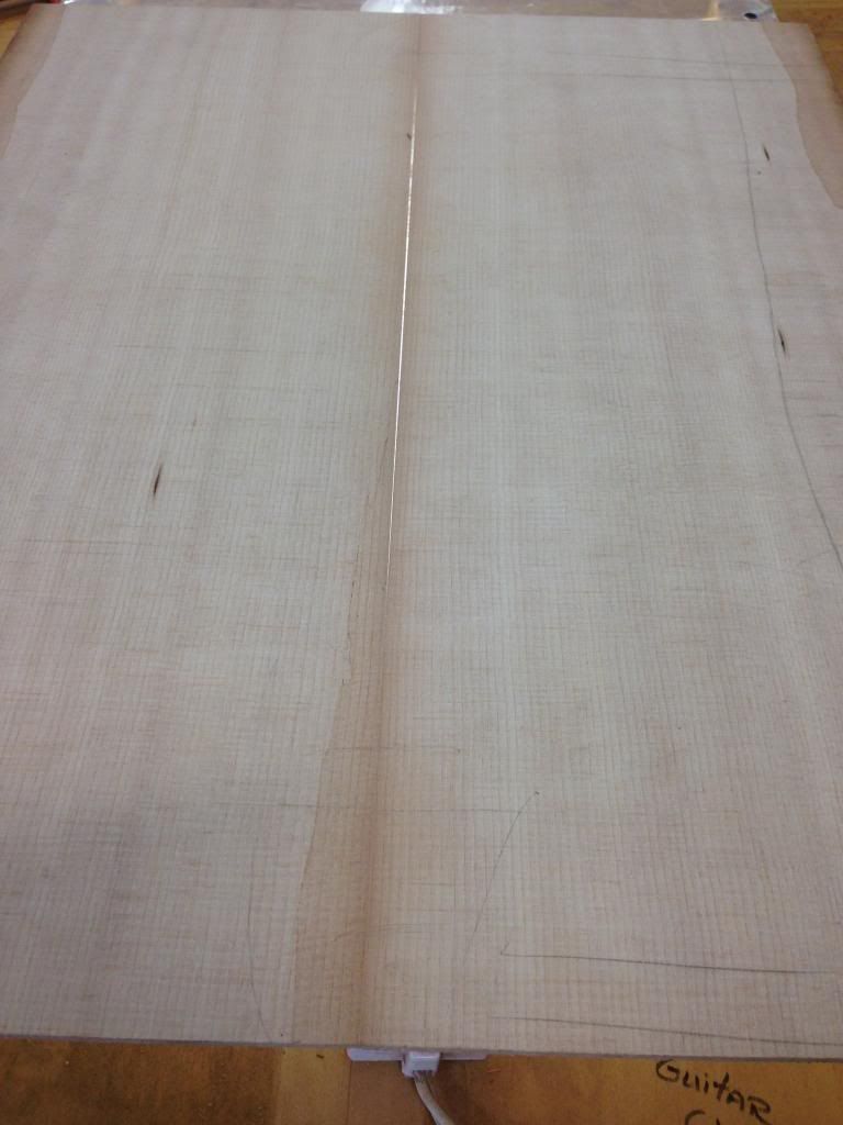

Alright these photos should satisfy the curiosity a bit longer while i cut out the bracing, and bend the sides, oh i almost forgot i have to finish the neck!

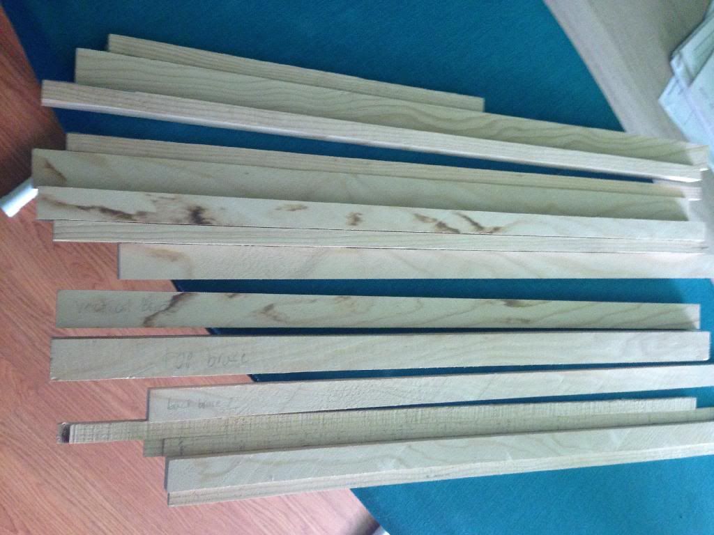

Thanks for the support guys, so a weekend update... I cut out all of my bracing I'll be using Sitka Spruce and mahogany for the neck and heel block. As far as the guitar neck I'll post more pictures once it's roughed out but it'll be a walnut and maple neck.

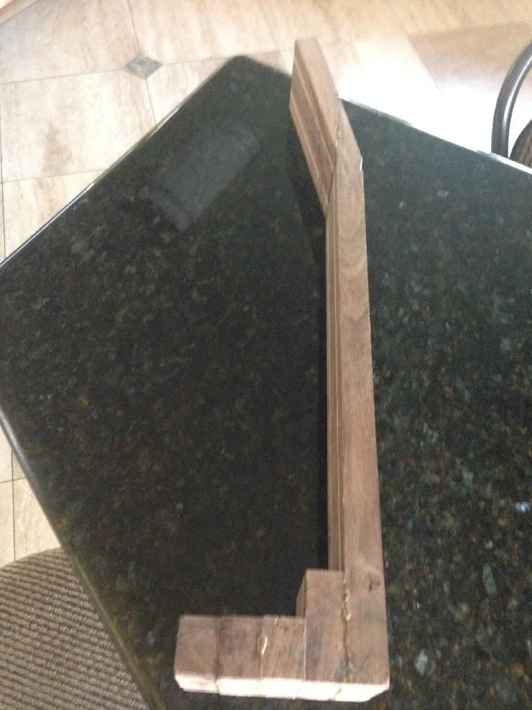

Sorry about the long break guys i've ben terribly busy with other projects. Anyhow heres the guitar neck roughed and ready to go and my pile of braces for the Selmer... funny enough the pile looks bigger in person.

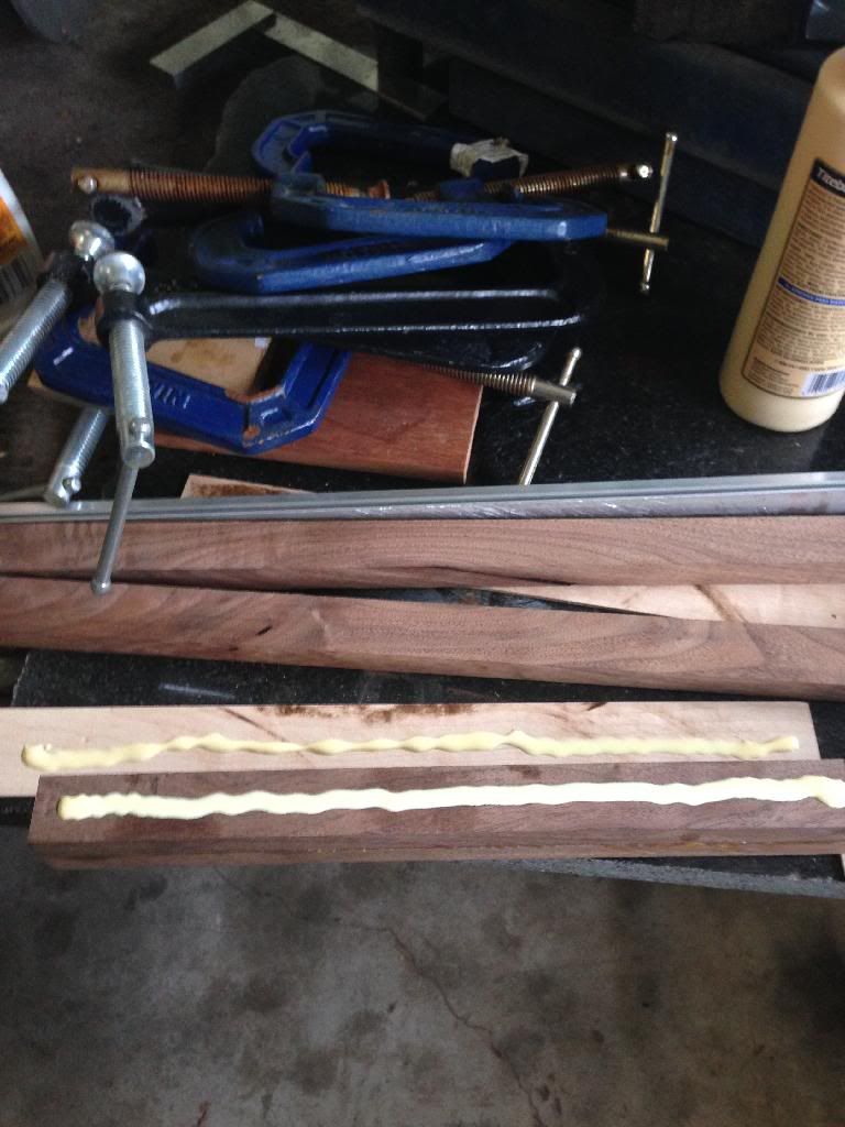

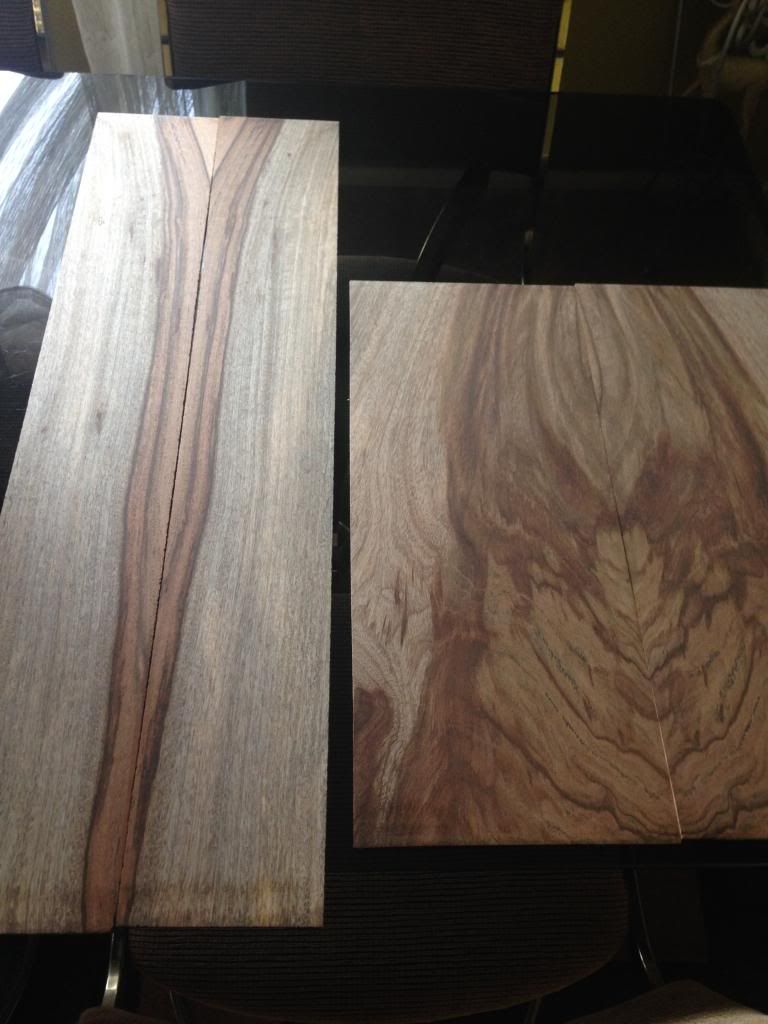

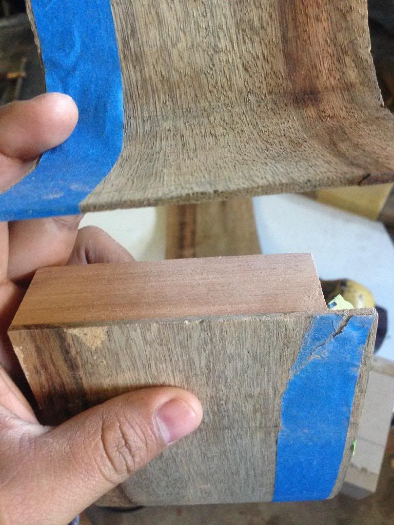

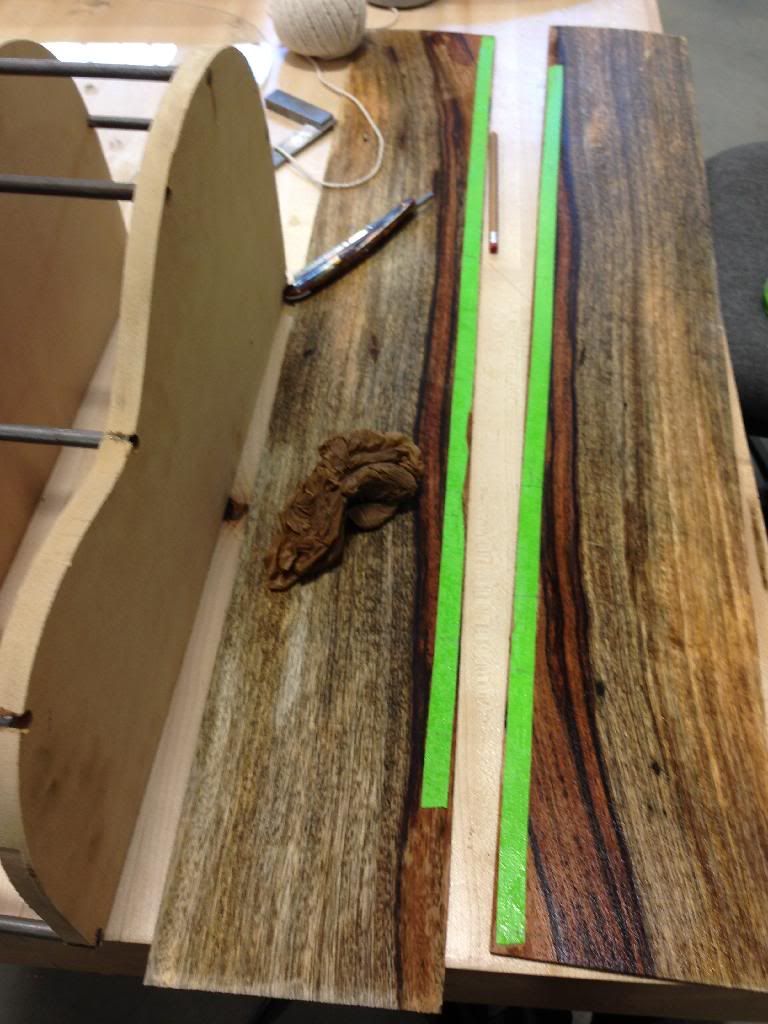

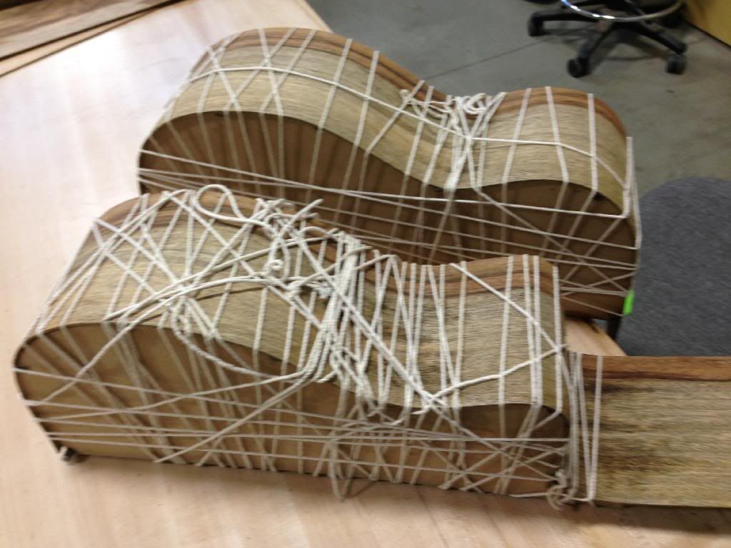

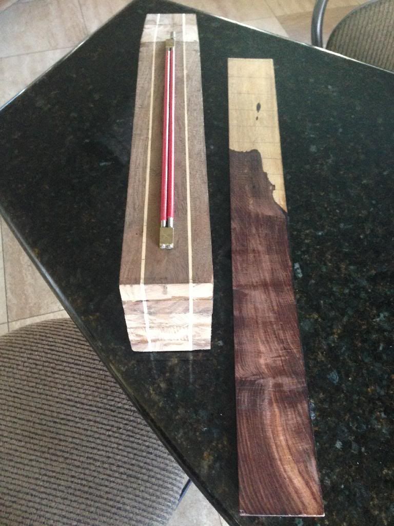

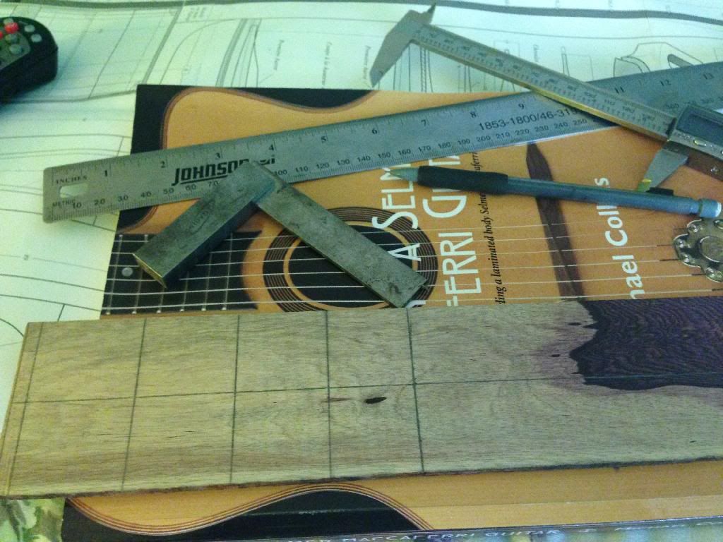

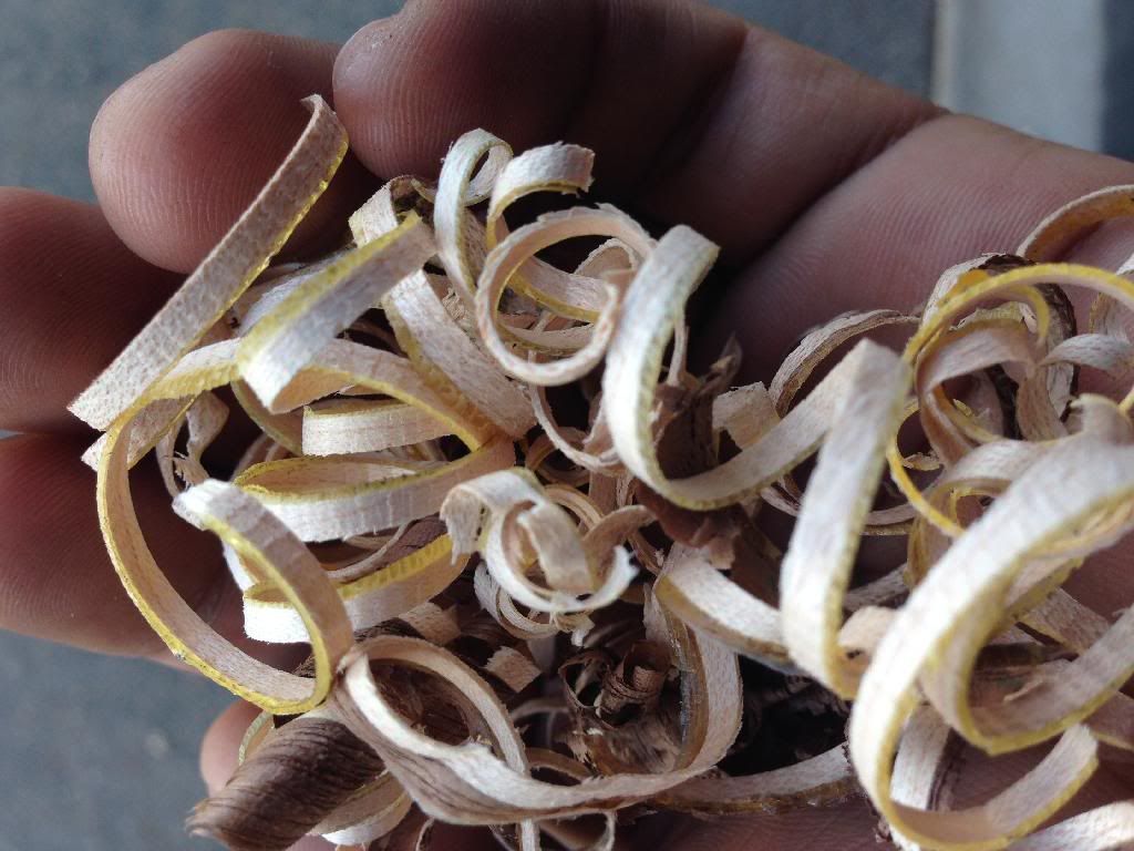

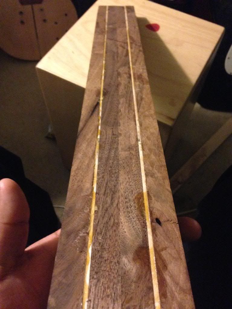

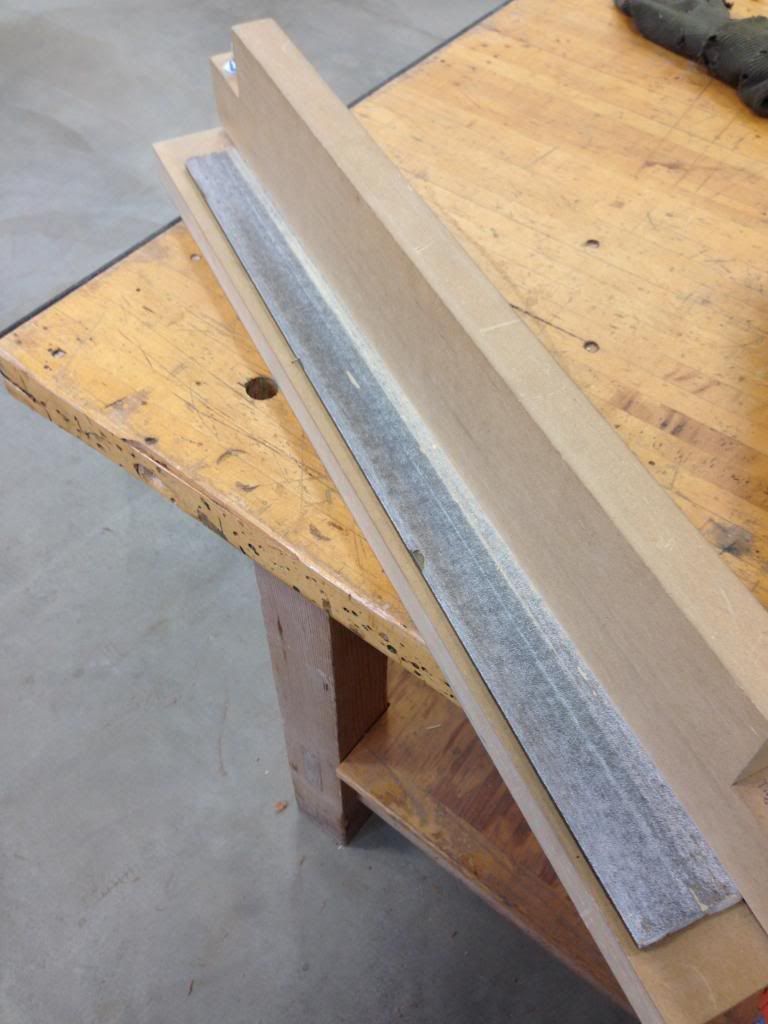

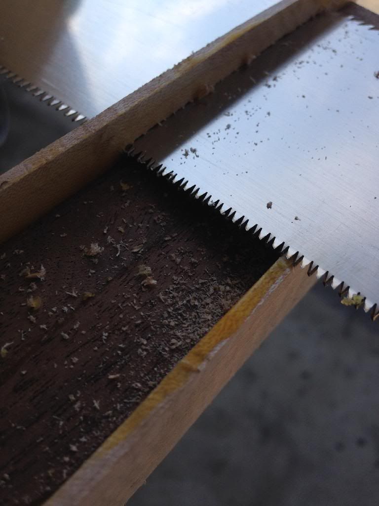

Hey sorry guys for the long two week break ive been building my new shop but i have been working on my Maccaferri! So far ive thinned down the Top to 2.1 millimeters and the back and sides to 2 millimeters. I bent the sides by hand and honestly i dont know why people dont bend guitar sides that way it is such an enjoyable and relaxing experience doing this by hand. Last week i cut 2mm thick strips of Maple and Ebony that ill be using for the rosette. I also the scarf joint and began planning the dovetail joint on the Walnut neck. For the Fretboard, Headstock,Bridge, and binding i decided to use Mexican Kingwood (Camatillo) which is in my Unprofessional opinion the most beautiful wood in the world. anyways thanksfor the support and cheers guys! enjoy
-Sean

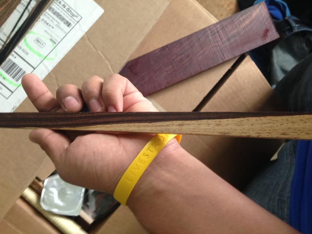

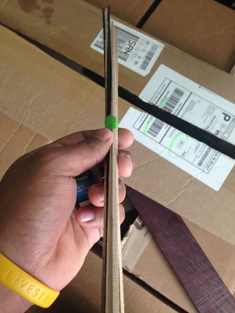

Heres the future Binding material
Rosette material... just look at how thin it is!Image
Heres my Fretboard with the frets being calculatedImage
Heres the sides, and lets play Spot the Mistake!ImageImage
Mango has got to be one of my favorite woods and one of the most beautiful. Super resonant and very easy to bend!Image
Heres the neck, fretboard and Trussrod!ImageImage
Bent sides 1 week after bending

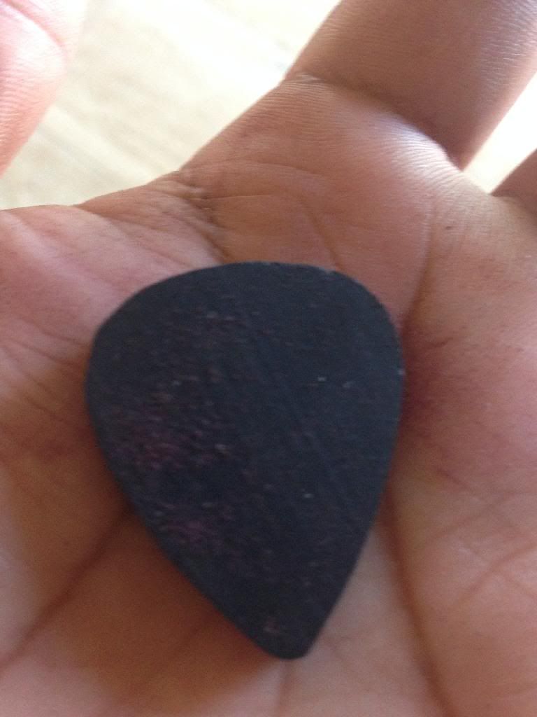

A super Kustum Guitar pick for the Maccaferri Jazz sound (actually just a piece of ebony i cut to resemble a pick)Image
More Camatillo!!! this is my headstock its rather tame considering the species.
Well heres the update, Thank you very much for the support and advice from everyone and plan on more updates from the Adventures of Sean and his Plane!
Cheers!!

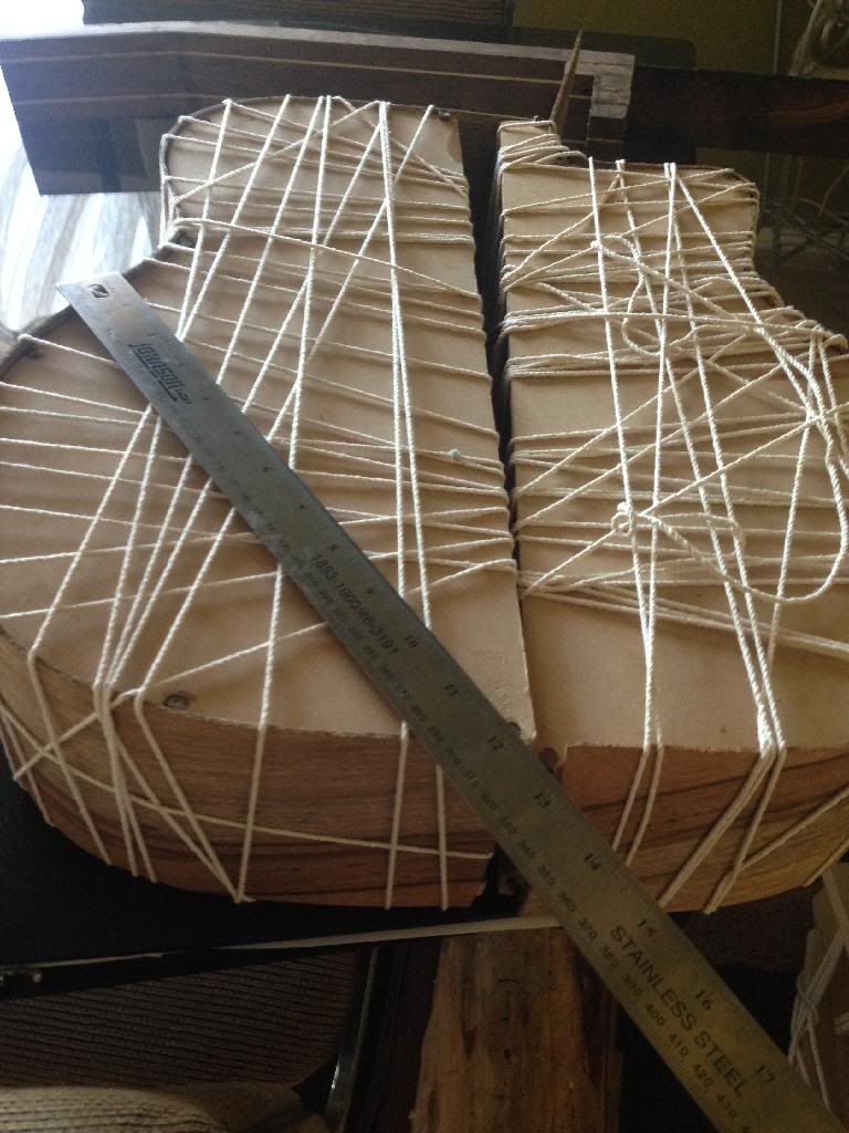

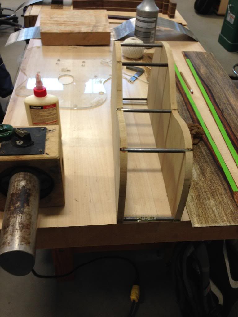

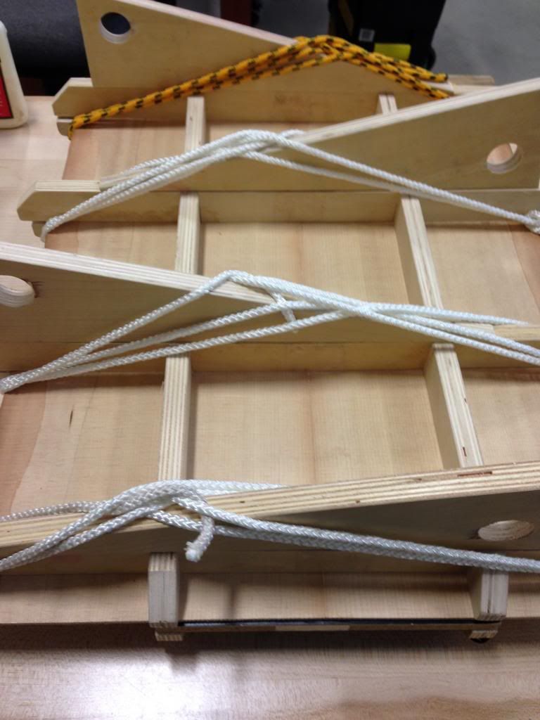

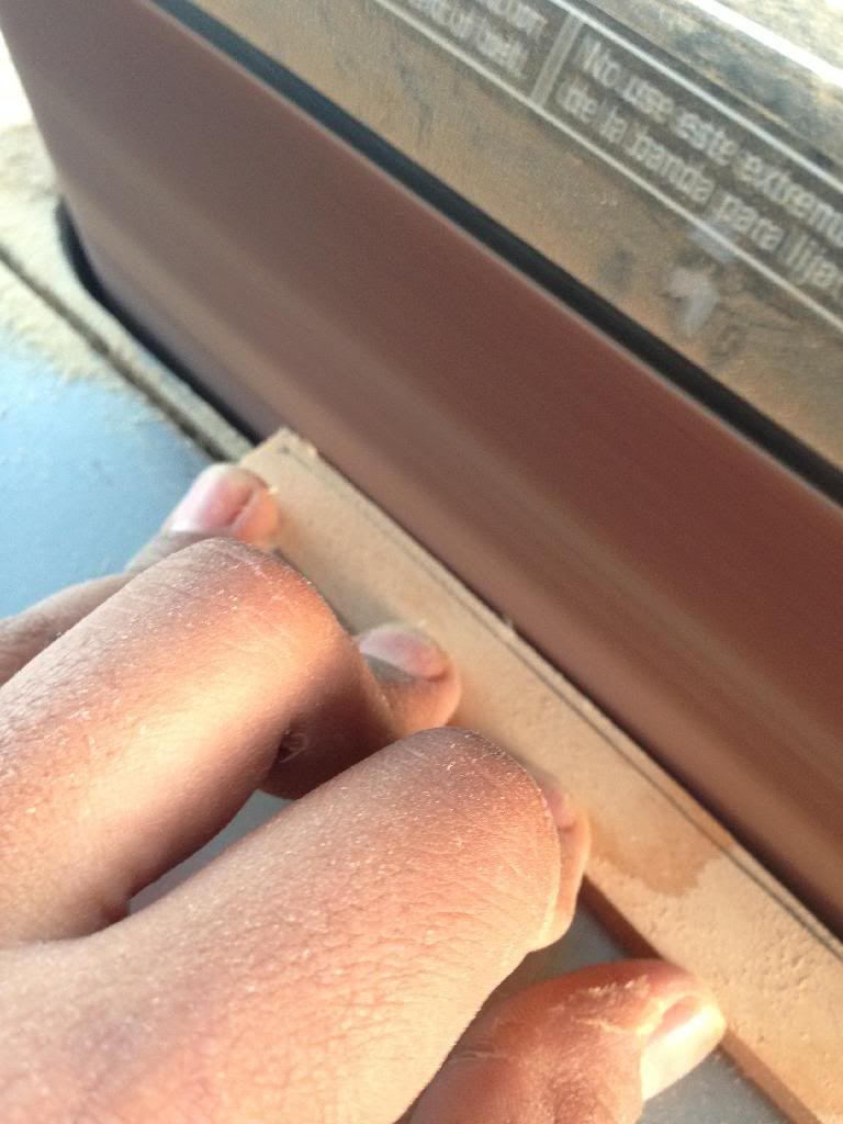

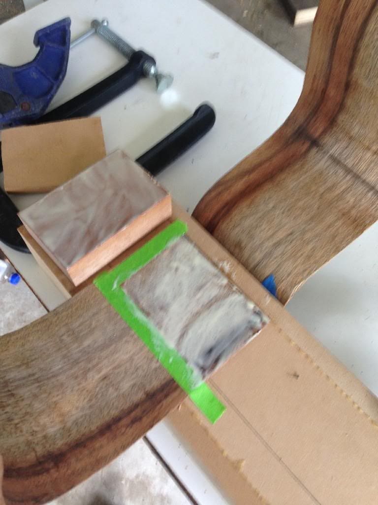

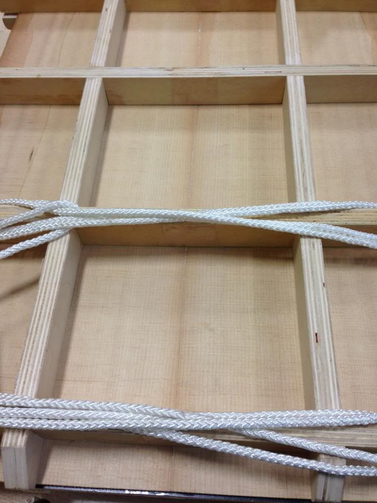

Hey guys, heres a weekend update i braced the back and tomorrow ill be gluing up the tail and heel block to the sides as well as trimming them to size, hopefully i can also start and glue up the rosette and start the Pliagé or 6 degrees bend on the soundboard as well as bracing the soundboard. dang no matter how much work you put into an instrument you realize theres a whole lot more.

Seanspqr_1 wrote:
Love this pic. The randomness of a fingerprint with the wood curls. Only the maker has a mark!

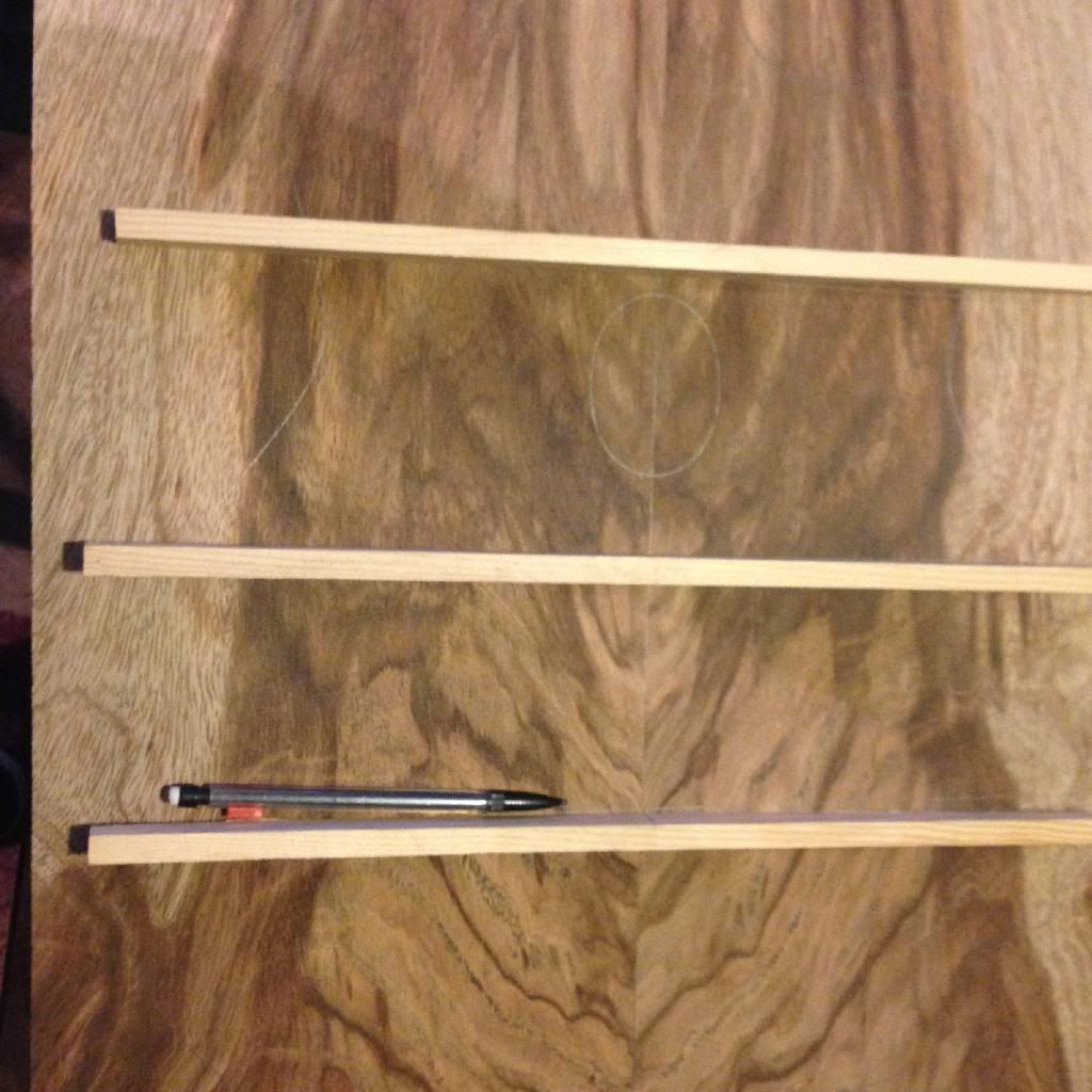

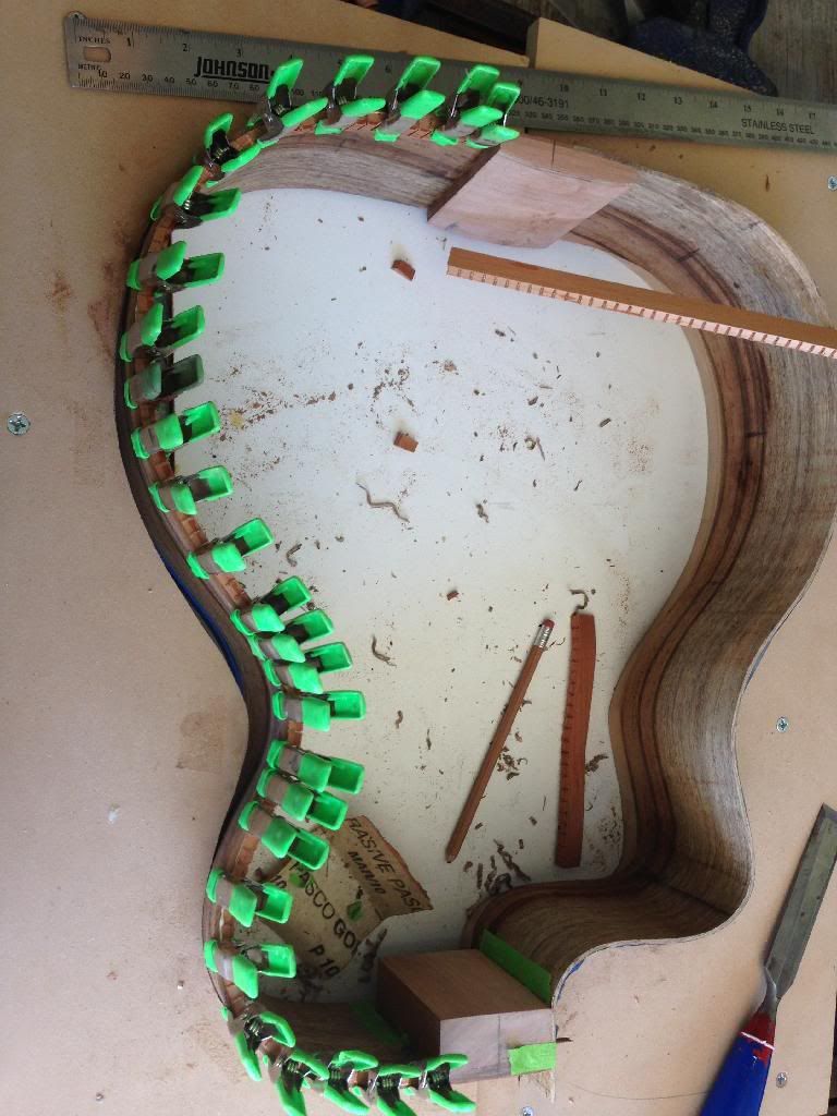

wednesday update, i need to finish this guitar by May 2nd so we'll see. i glued up the tail and headlock and installed the back kerning. i was going to glue the back but i don't have spool clamps so i won't until i make some
