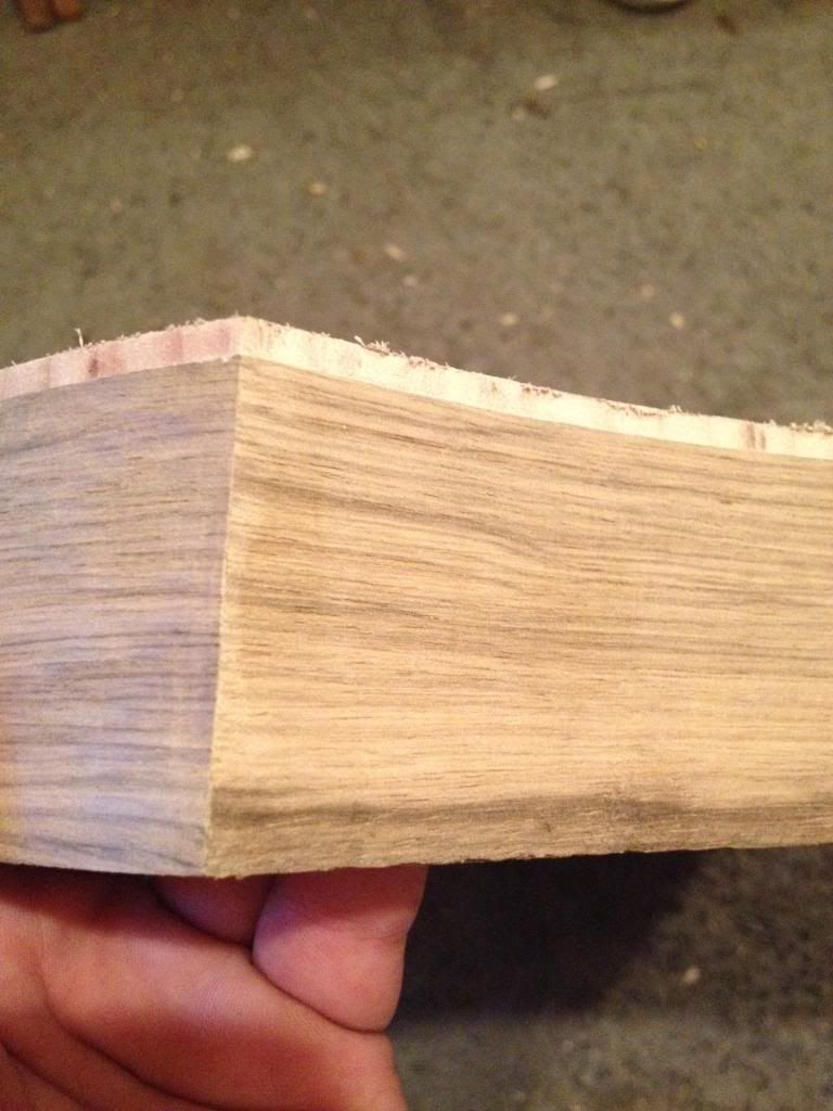

Here's what I do. This cutaway isn't as pointy as some but it's one that I had pics of my process for building it. First I find the total angle and then divide that in half to get what the angle of each piece will be. (Actually I just eyeball it and guess.) Then I cut the angle on both pieces trying to remove as little wood as possible so the grain lines up when I'm done. It's good to have a small shooting board for this. Then I glue the block to one side of the pieces. The block has some flat spots so I can clamp it easily.
Then I fit and clamp the other side piece to the block.
When I'm done I carve the block to the shape I want to remove excess wood. I do the cutaway before I glue the side to the end block and the head block.

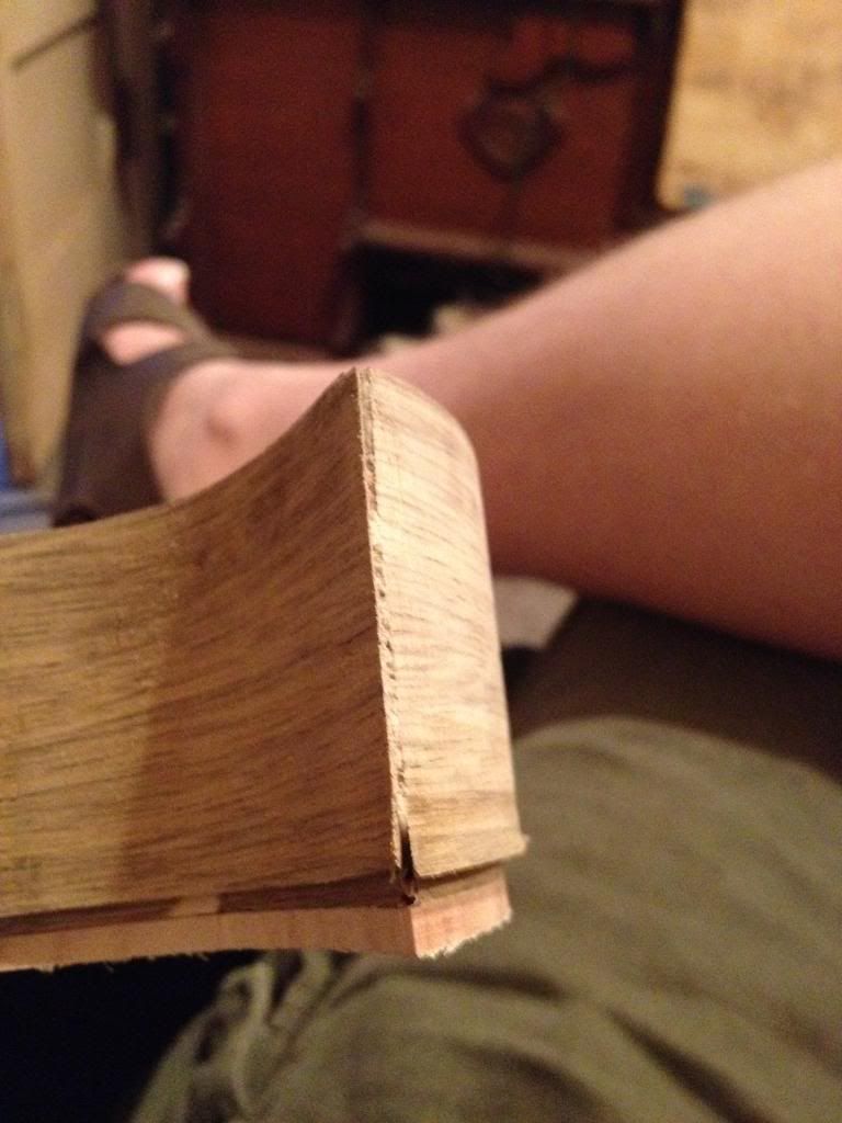

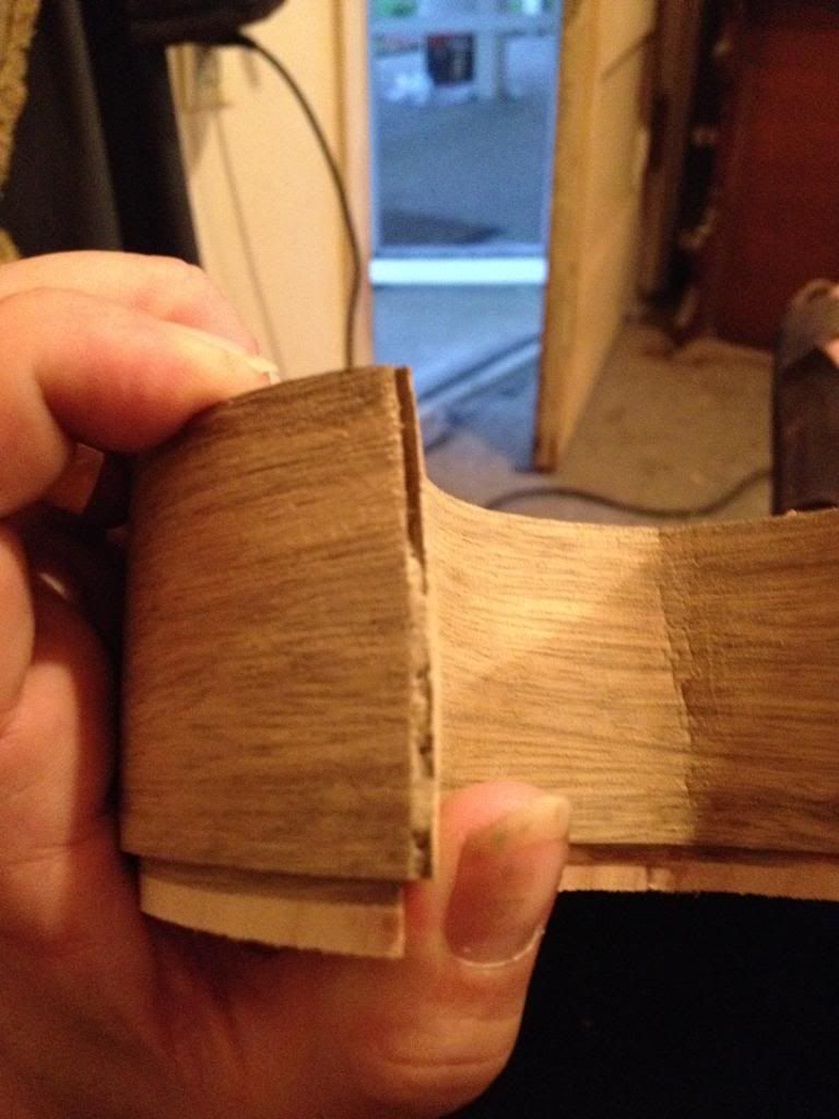

Ok here's what I got. I waited till I had the top glued to the sides and binding channeled before I decided what to do. As you can see and please don't mind the dried glue gobs, that one is almost perfect and the other real tiny. Should I use my saw to open the gaps a lil wider to install the binding strip. Also what about gluing a piece of Limba in each crack? Idk thought I would double check with you guys before proceeding.

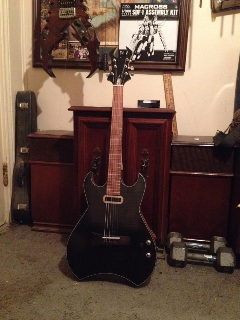

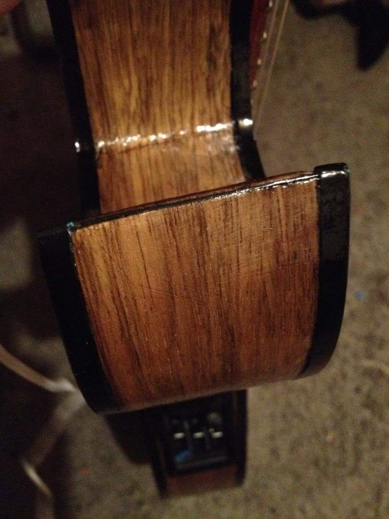

PostPosted: Thu Jun 12, 2014 9:23 pm
Joined: Mon Sep 30, 2013 12:51 am
Posts: 280
Location: Where Palm trees grow
First name: Jeremy
Last Name: Wood
City: Galveston
State: Texas
Zip/Postal Code: 77554
I found this link too late but and it doesn't show the finished product but this is what I should have done.
http://inlayinnovations.com/guitars/a-s ... -2-monday/

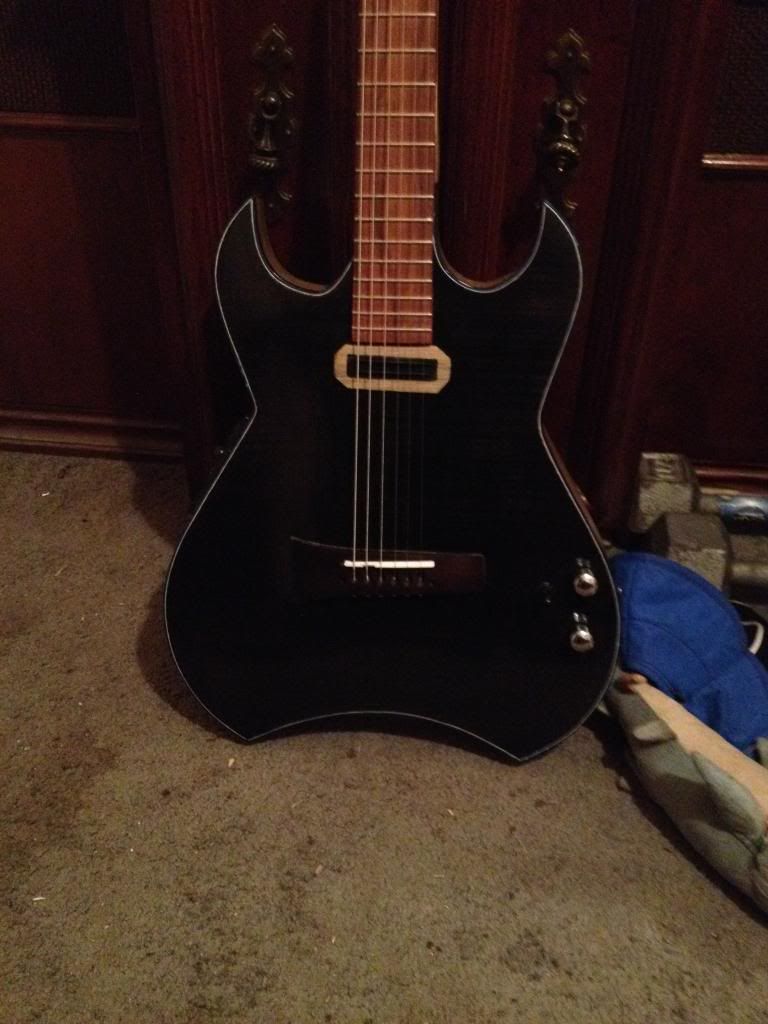

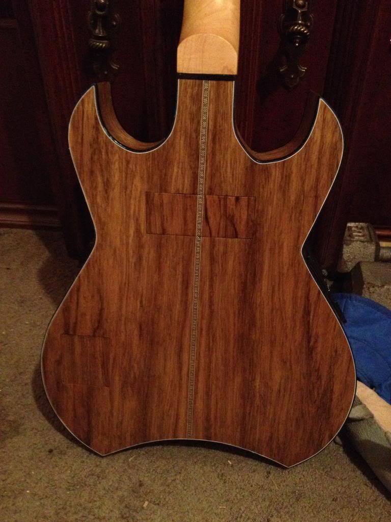

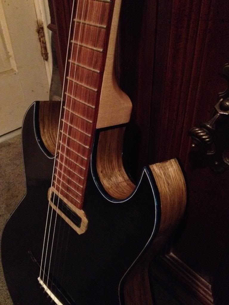

I noticed that the black limba's grain easily blends well. So I prolly could have just grafted a small piece in and re shaped it. Oh well this is how we learn and I can always fix it later. Any way here's some pics of the finished product. The last pic shows the top joint.
