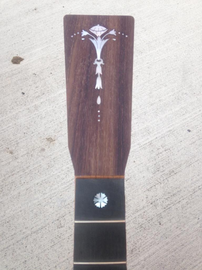

What have you been using to light your work as you rout inlays? I trace the pearl with a fine pencil, have overhead (bright) fluorescent lighting, and wear an optical magnifier headset with an led light built in. I am STILL having a hell of a time seeing the pencil outlines as I rout.
They are easy to see until I bring the dremel router base over them. Then the shadow it casts makes the lines virtually disappear.
Is there a bright white pencil I could be using instead? Some other lighting?
I'm getting good results but it takes longer than necessary, gives me a headache, and I'm getting unnecessary gaps at time because I couldn't see clearly enough.
