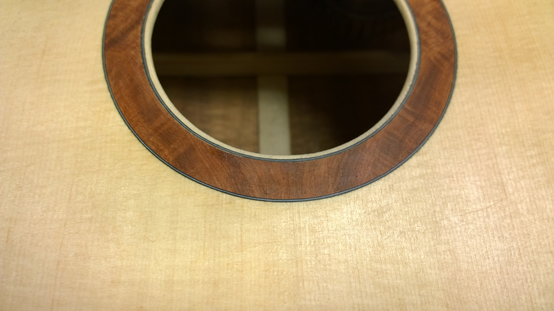

I been following the Gore\Gillet Comptempory Acoustic Design (Build book) to put together the Medium sized steel string guitar that they have plans for in the book. The guitar has a lutz spruce top frorm Shane's last batch and a Australian Blackwood back. Unfortunatly it has Koa sides as I went to cycle a side for the second heat cycle after bending it and left my controller on the full power option, lost the side and the heat blanket. I was right in the shop two feet away reading on the internet (whats that smell? ...). I did find with medium amber shellac I get a good color match.
The carbon fiber on the top kept the top in the prefect shape. Absolutely no spring back. There was even a bit of vacuum when I put the top on the radius board that the top was glued up in. A straight edge on the fret board extension area of the top gave me the perfect 2.5 mm at the saddle that I am looking for.
On to the bolt on bolt off neck ...

I have become a convert to the falcate bracing, I just retopped a 12 string I built a few years ago with a falcate top making the braces 9mm tall...can't wait to see how it sounds...
the back and sides wood combination is cool!!!!!! [:Y:] [:Y:]

How much extra work was the falcate bracing, and how much more than usual did you spend on materials such as the CF? Was it as hard? Twice as hard? Etc...
These users thanked the author meddlingfool for the post: Al Pepling (Mon Jun 16, 2014 7:35 pm)
I have a small strip of carbon fiber that I pulled a half dozen strips of yarn from, so cost wise no big deal. There are a lot of extra steps to falcate bracing. I had to cut, thickness, bend and then laminate the falcate bracing. I made them 2.5 times too tall and cut them in half to give me the two braces. Epoxy them down with a carbon strip, shape the brace and them finish with another strip of fiber.
Gluing them on is a little harder, Calendar time it takes at least a couple of days (it took me 4 days) to glue the braces on, mainly because of the epoxy cure time. First the brace and a strip of fiber needs to be epoxied down and then the following day a strip of fiber needs to be glued on to the top of each brace.
I would say all and all it takes at least twice the hands on time for bracing the top. A lot more time to get them made and glued down and a lot less time carving them afterward. (There is no carving of the braces once the fiber is glued on top. ) Also I did not radius the falcate braces. Just pressed them down. With the CF there was no spring back.
I have pretty detailed pictures with some commentary on my web site.

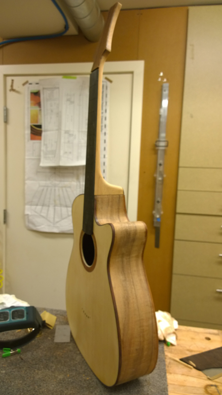

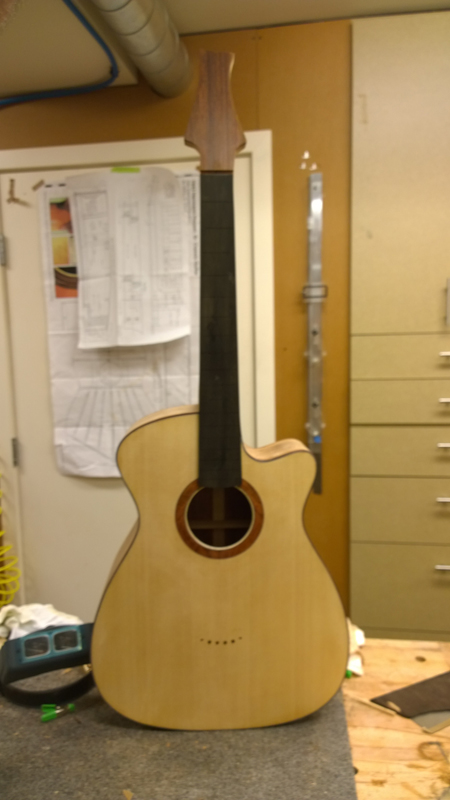

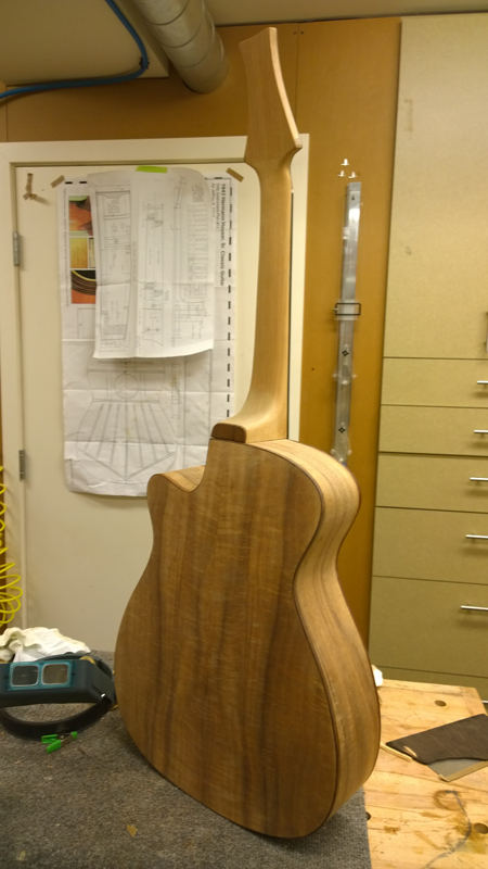

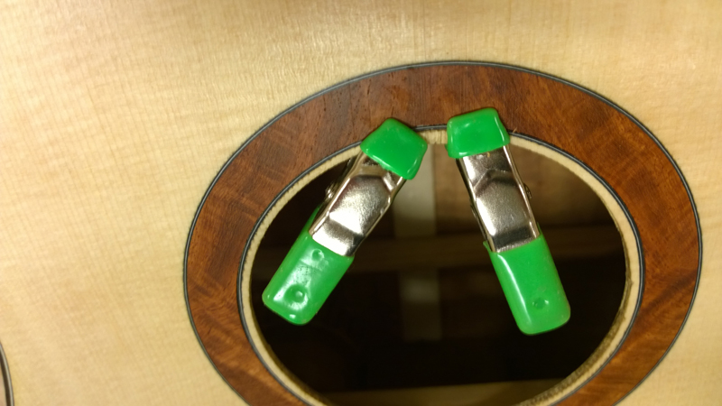

I am close to finishing the construction of this guitar.

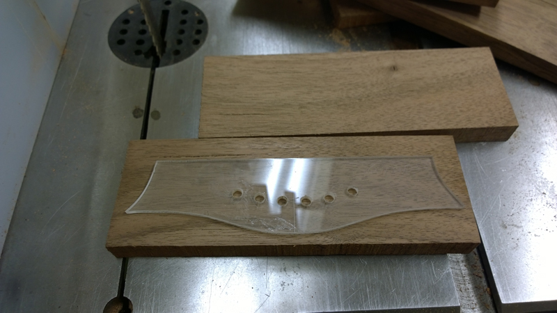

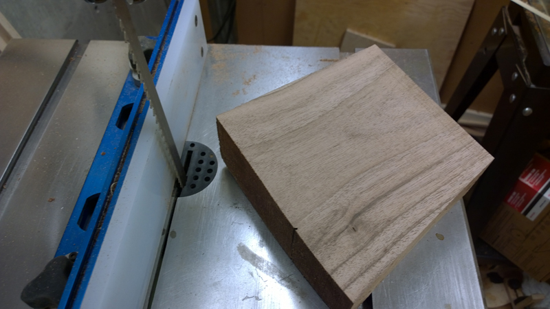

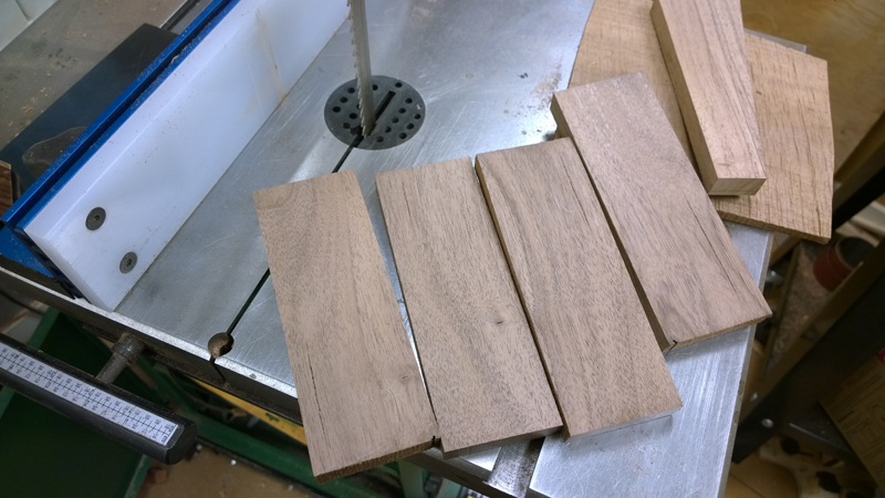

I have been spending time cleaning things up. Filled a couple of gaps. One repair I had to make was to the spruce between the rosette and the sound hole. Somewhere along the line I knocked a bit of it out. Luckily I have a spruce ring underneath so I had a ledge to build up. I shaped a small piece of spruce from the cutoff to fill the cleaned up chip and glued it in with hot hide glue. It is hard to see the repair.
While I was waiting for the glue to cure I sliced up a block of walnut to use when I make my bridge. As in the Gore\Gilet book I will make a carbon fiber reinforced bridge and will ebonize the walnut. I will start rusting some steel wool tomorrow to make the solution. I never tried it before so it should be interesting.
Tomorrow, drill for the tuner holes, inlay fret markers and make and inlay my hawk and moon logo in the head stock.

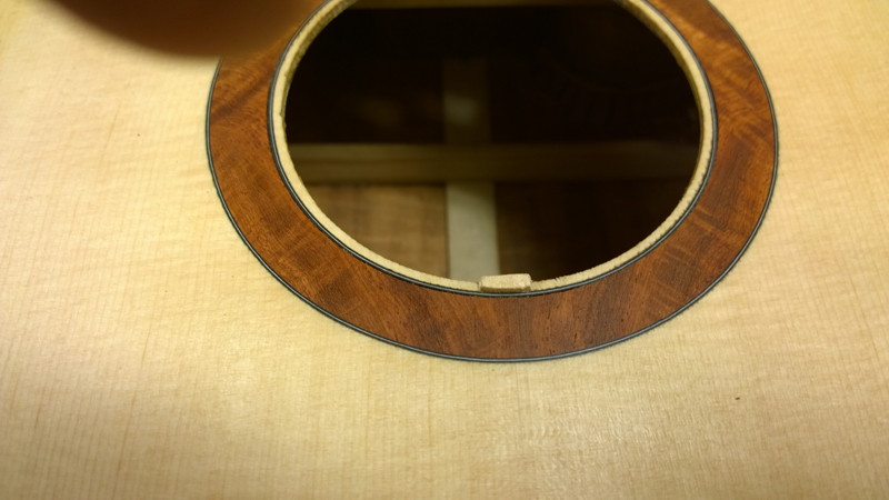

Nice repair!! What router are you using? I have gone to a proxxon router with 1/8" multi faceted carbide bits. It is awesome for this type of work and never tears out.
Michael F Smith
Goat Rock Ukulele
http://goatrockukulele.com
PostPosted: Tue Jun 17, 2014 5:47 pm
Posts: 1715
Last Name: Parchem
City: Seattle
State: Wa
Zip/Postal Code: 98177
This was not a tear out I whacked it with my heavy steel straight edge not paying attention when going to check the neck angle. I have a few routers. I use a Porter Cable 310 for the rosette. The multifaceted carbide bits sound good. I use a 1/4 inch end mill.
