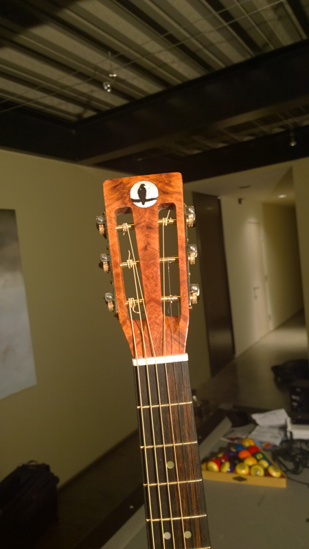

I finished stringing up my 12th instrument a 00 sized cutaway with arm bevel. This is my first instrument with an arm bevel and a cutaway. A lot of interesting challenges for both. I will post a sound clip before the weekend is up. The guitar sounds pretty good. I still need to do a bit of setup work but I wanted it to sit for a couple of days.
Thanks for looking and also thanks for all of the positive comment throughout the build of this guitar.
Western Red Cedar Top
Koa Back and Sides
Ebony Bindings, are bevel veneer, and bridge.
Brazilian Redwood fret board.
Amboyna burl headstock veneer and rosette
Mahogany neck.

Thanks for the kind comments. The guitar does have a couple cosmetic flaws, that I did my best to minimize on the guitar but over all I am very happy with the way it turned out. I was playing it for about an hour today and it does sound really good.
For now this guitar is for me, I do not have a steel string. The finish for this guitar is water base lacquer EM6000 over zpoxy on the back, sides and neck. Over a blond shellac wash coat on the top.

A close up? then you see the flaws, like obviously not sealing enough before using CA. I padded on shellac three times. I decided the streaks added character and it least it was not green, which happened to me with spruce. The rosette is made with book matched slices from a block that I think was Amboyna burl. On the face of the block that I did not use it had the typical Amboyna burl pattern that one sees so often. I found the bock labeled "misc" at Rockler Woodworking. I used a double strip of fiber purfling for the black lines. I really wanted the line to read, especially with the ebony bindings.
So here is the close up
