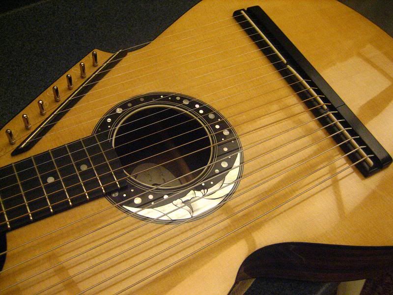

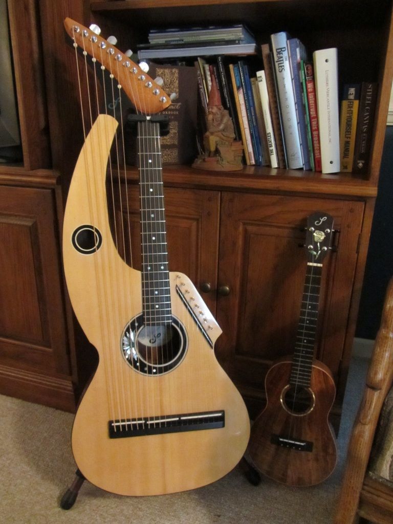

My harp guitars need really stiff tops to support 20+ strings. I only use Lutz on all my builds.
Michael

On a different note, Michael that's a mighty fine looking Harp guitar, very very nice looking workmanship.

Hey..Thanks Steve. That is 3 Harp Guitars and a Tenor Uke for my wife (It does not have a Lutz top)
Michael
Wow, Michael! I think you could take the "semi" away from the word "pro" :)
