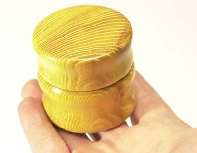

It turns pretty well too. I gave this to a guitar teacher buddy of mine.
I have some sets in the que but haven't made a guitar with any yet.
