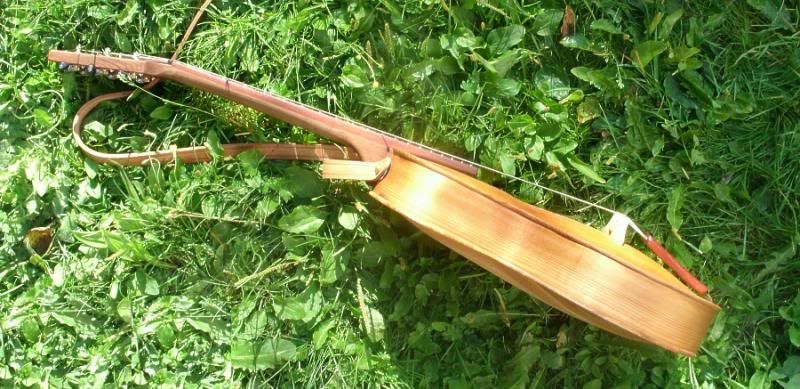

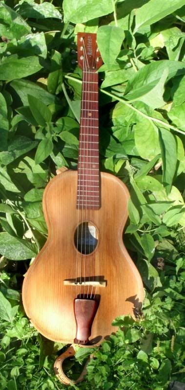

Knocked out this sweet little carved arch top parlour blues machine for me lady friends birthday.
Carved from 1 1/2 inch thick plates, at 12 1/4 inches wide, the plates are quite voluptuous...
just like me sweetie. bliss
23.5 inch string length
upper 9 1/4
lower 12 1/4
carved top and back, violin edge, bwb purfling
50 year old air dried strawberry cedar body
Neck chocolate cedar
Padauk head stock plates, fret board, heal cap and tail piece
Lilac bridge, cocobola strap pins
Oil finish.
Stay tites
Extra super lights .008 .010 .015 .021 .030 .038, 3 neekid, 3 wound....but gonna change them to mediums.
Me making one more for me self, from spalted birch and lutz and then me be destroying the bender shape and mold.
bleessings,
duh ?adma
