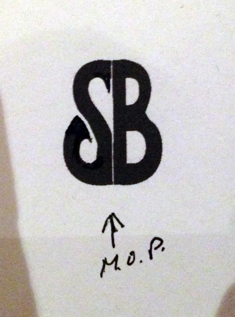

Possible headstock logo in mother of pearl

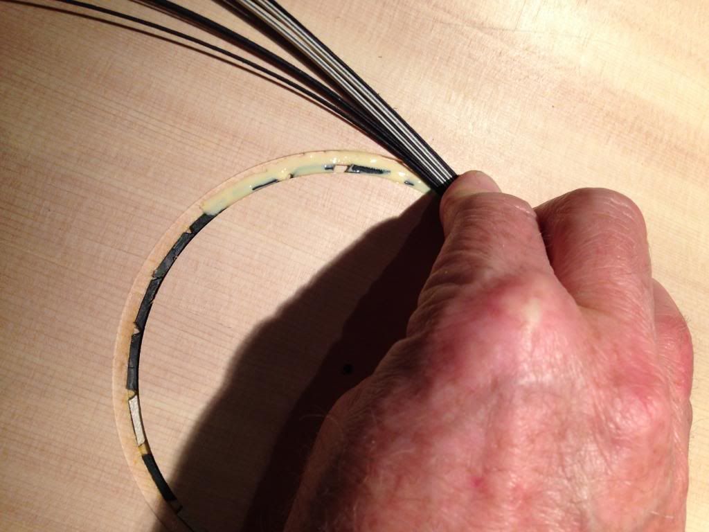

Inlaying the purfling made of very thin strips of maple and dyed maple. This part is stressful but exciting. I managed a very tight fit. The odd black strips sitting in the circle are purfling strips that I'm using to build up part of the channel because the router height adjustment slipped a bit. It will never been seen again. Takes a rookie...
I'm using my polished jointer's hammer to tap in the purfling.
I'll admit it... I'm pleased. This could have turned out much worse. I still have to shave down the top of the purfling and make it flush with the rest of the top. I will do that in the morning after the glue has had a chance to dry and cure over night.
The rosette has been leveled. I'm very happy with clearing this hurdle.
Detail of leveled rosette.

Wow. That top has crazy medullary rays! Looks awesome! Nice work on the rosette too!

+1 what Tony said! The rosette is beauty in simplicity, and so well executed! Keep it coming, Steven!

How do you keep your shop free of dust? My shop gets covered in thick layer of dust in only a few minutes of working, and this dust is pervasive!
As for the rosette... I think CA method is going to be less stressful. Fit it in the channel and simply drip CA over that.

I do like that rosette! Very nice. Like the pictures. If you ever do decide to go with the CA method, be sure to seal the channel and area around the rosette with shellac before you use the CA.

Thanks for the nice comments about the rosette! I wanted something simple and stately that suits the guitar design. Tai Fu, the dust is there, though I'm not using much in the way of power tools (laminate trimmer, screw gun). I'm trying to do as much by hand tools as I can without screwing it up.

Great job on the rosette, clean and simple.
I used to use CA for this task - no more.

From the look of you're rosette, no you didn't need to. It does make it easier sometimes, and can be important if you're using CA, which can wick into the endgrain and stain the spruce yellow.
