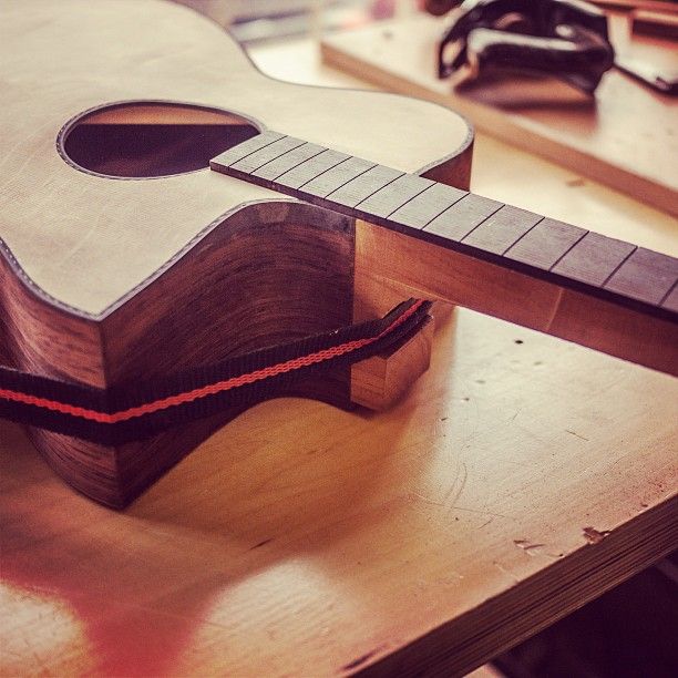

Not a riddle folks but the subject of my latest blog post. Take a look, I'd be interested to hear your take on the subject - what you've learned over the years.

Nigel: Interesting, must really raise the longitudinal stiffness. Wonder if the radius is even or just centered with the sides of the top flatter. Also, what is the radius your using? And the effect on overall sound ? Had considered doing this to the back of guitars but have not gotten there yet.

You are a daring man with that chisel, Nigel. I'd surely slip and leave a terrible gouge in the side. :-)

So is there a reason why many luthiers carve the neck already attached to the guitar? It seems easier to carve it without the body in the way, and no risk of damaging the body too...

Quite a few points to answer there:

Tom:"Wonder if the radius is even or just centered with the sides of the top flatter. Also, what is the radius your using? And the effect on overall sound ?"
I've no idea of what radius I'm using.
This should give you an idea -

Tai:"So is there a reason why many luthiers carve the neck already attached to the guitar?"
No! In that case I was trimming the heel flush to the sides whilst it was just bolted in place. That said, I've carved necks both on and off the guitar, off is a little easier, but I've never slipped with a chisel once whilst carving a neck. It helps to concentrate the mind when the stakes are high!

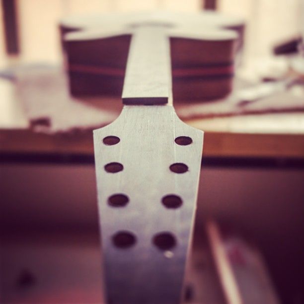

I've always had issue when doing a uniform radius on the top that there's always a gap under the fingerboard at the neck/body joint. If I changed the angle to eliminate that gap the angle is too high. So I'm contemplating a true flat top but radius the X braces so the body still gets into an arch of some kind but not at the upper bout.

If I understand you correctly, Tai, you are thinking about it backwards. You would be better off to radius only the upper transverse brace, and leave the X alone, like Santa Cruz did when they started out (I'm not sure if they still do it that way.)

I can't find the video you're talking about. I really like to know this because I find it hard to deal with that gap and really want to eliminate it. I just don't know about sanding the bottom of the fingerboard because it always ends up coming out weird...

Tai: my cylinder tops have a fixed neck and getting the geometry right is really tricky, but it's doable.
but Howe-Orme (the original cylinder top guitars) got around the problem by having a floating adjustable neck. Theirs is a very pragmatic design.
