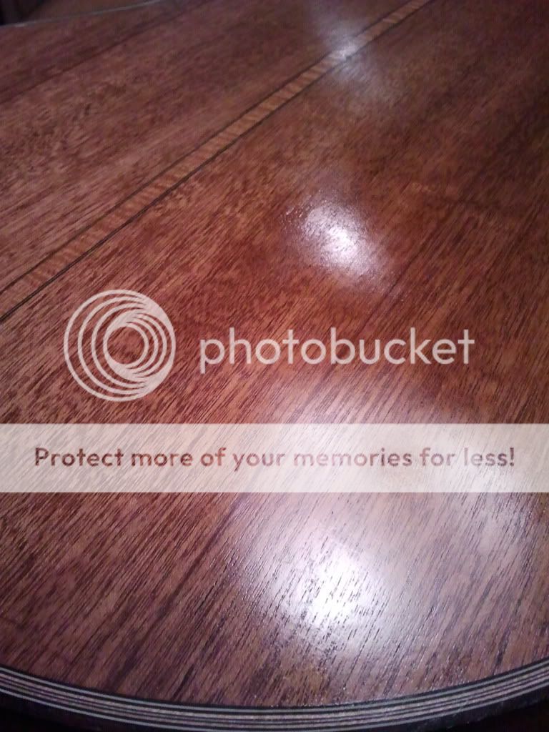

I'm French polishing my first build but I'm still a newbie and am ad libbing as I go. I've attempted to pore fill with pumice padded in with denatured alcohol but it could have gone better:
I've since sanded the back with 400 grit sandpaper and then rubbed it with a small amount of acetone. After that I worked in the pumice again and then went to 2 pound cut shellac and things are much smoother. Not glass smooth but smooth enough for a gloss finish. Now I'm attempting to do the same with the sides which are much more difficult.
