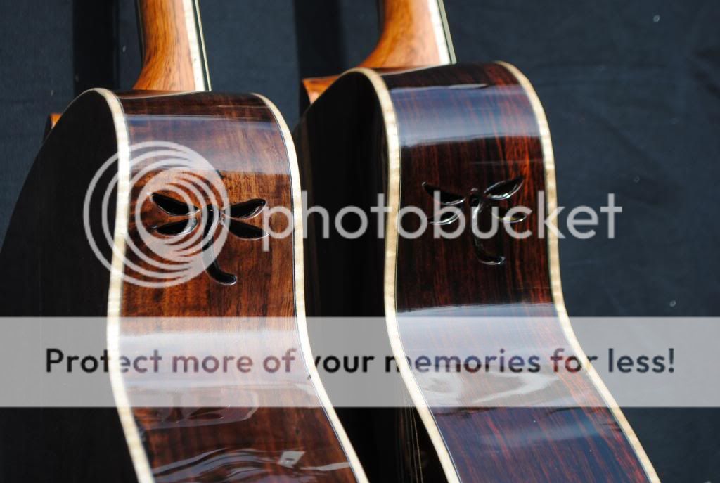

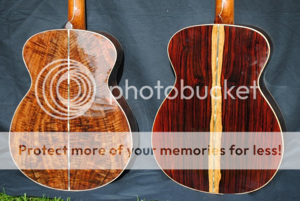

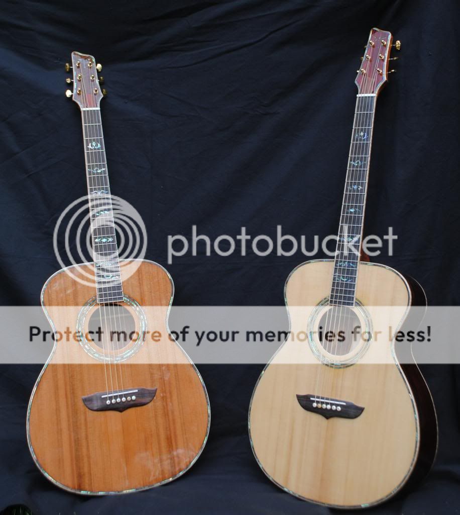

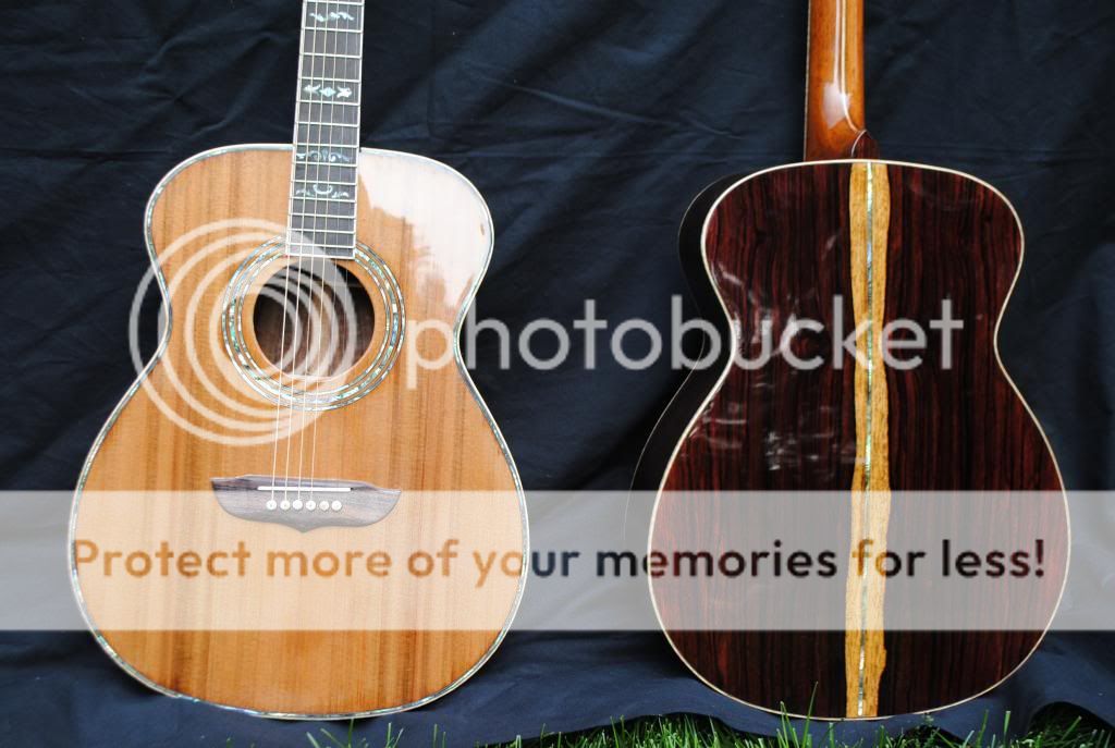

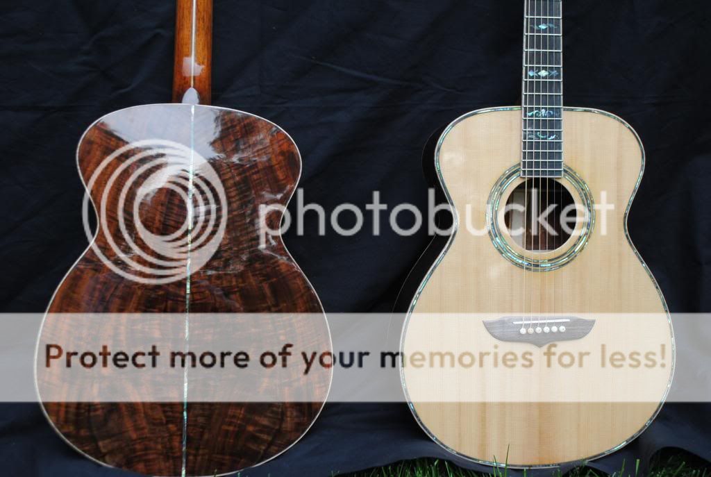

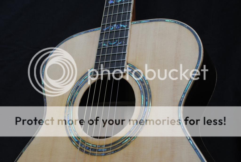

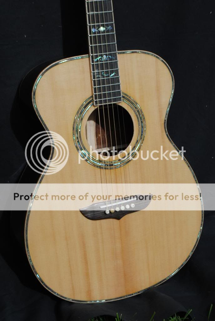

I just finished these two and will be sending them off to their new owner this week.
Thought I would share some photos.
These were commissioned to see what effect wood choice really has on tone.
So here are two, nearly identical, instuments built from contasting woods.
One is Adi/cocobolo
The other redwood/claro walnut
They are each adorned with abolone shell and flamed maple.

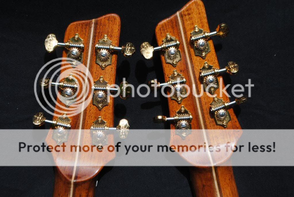

I incorporated an adjustble neck design into these builds. Also unique are the truss rod covers which are held down with rare earth magnets.
The tops were tuned using chladni testing methods and are nearly identical in their response patterns and resonant frequencies.
I am amazed at how close the tone sounds on these two. The adi is slightly more punchy and the redwood deomonstrates more warmth, but overall, they sound VERY similar. To me, it demonstrates that tone is very much a factor of how an instrument is built with a little characteristic of the wood thrown in. As opposed to the other way around, which is how many people view guitar woods.
Here are some photos.
Enjoy,
Dave

Can you provide some more info/pics about the adjustable neck joint?

Thanks everyone for the kind words.
The adjustable neck was based on designs of Mike Doolin and Dave DeFoite.
In simple terms, the heel was let into the sides, as opposed to resting on the sides like traditional builds. There are three contact points, made from 1/4" set screws that the heel bears down on. If adjustments are needed, the main bolts are loosened, set screws adjusted, then the bolts are tightened again.
I really need to figure out how to make it adjustable from outside the soundhole, but haven't gone there yet.
Unfortunately I don't have any pictures.
Thanks again for the comments.
