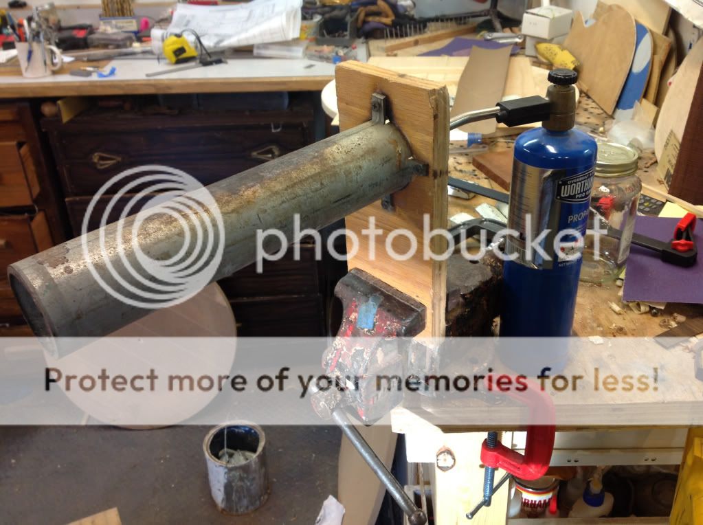

PostPosted: Sun May 05, 2013 5:13 pm
Joined: Fri Dec 23, 2011 10:17 am
Posts: 295
First name: Linus
City: Brooklyn
Zip/Postal Code: 11215
Well, a bending pipe will be necessary at some point so I might as well jump in.
I bought a 10" section of 1.5" pipe. Is galvanized OK? It's what they had. I got a propane torch. And they had a perforated rectangular plate. Tin? Almuninim? I'm not sure. I made a couple slices and bent it up to make a cone shape that I could jam into it to mostly plug the end while letting it breath.
I'll be able to lock it horizontally in a vice. Will this be OK??
PostPosted: Sun May 05, 2013 7:34 pm
Joined: Sun Sep 16, 2007 1:27 pm
Posts: 716
Last Name: Livermore
State: Minnesota
Nice.
One little mod and you have a usable bemding pipe.
I cut the little tabs with a hacksaw, bent them with pliers or vice grips, dirlled holes and voila.
Many sets have been bent on this set up and you are almost there.
Dave

PostPosted: Mon May 06, 2013 1:38 am
Posts: 3622
First name: Dennis
Last Name: Kincheloe
City: Kansas City
State: MO
I think galvanized can produce toxic fumes when heated... not positive though, and perhaps not unless you get it hotter than it should be for side bending, but do look into it.
As for clamping in a vise, it'll probably work. My pipe is 3" diameter steel, free from a muffler shop scrap bin. Mounted to a board with L brackets and bolts, and then I clamp or screw the board to whatever surface I want.
