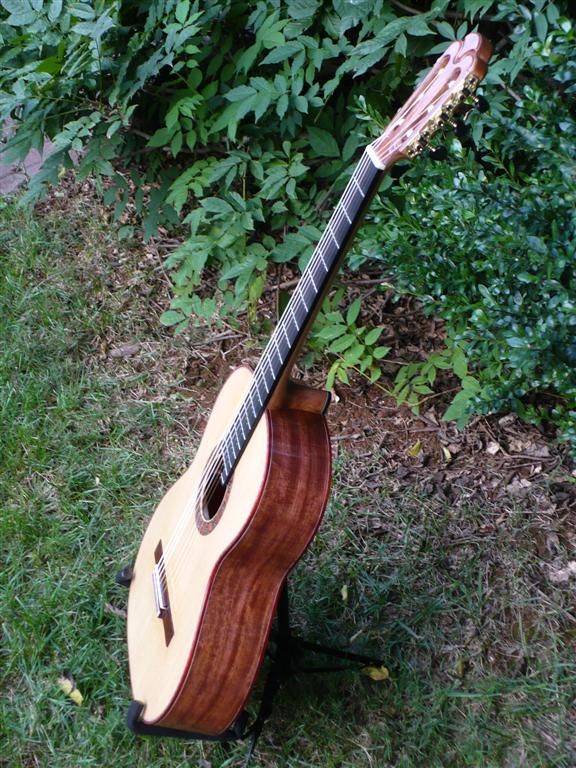

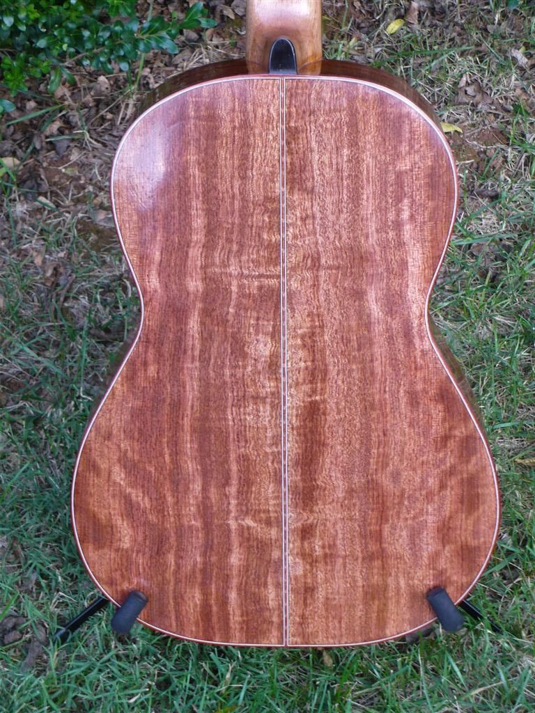

I'm building an elevated fingerboard guitar following Mick Lazar's approach, which has a Bubinga body. I got my Bubinga in a binge at the local Woodcraft about 5 or 6 years ago, when they brought in a stack of good-sized QS planks, some with decent figure and some plain. I have about 10 sets sawn and enough wood around to do another 6 or so. I think it should work out well. (I have a bunch of Padauk obtained the same way.)
