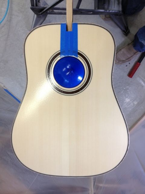

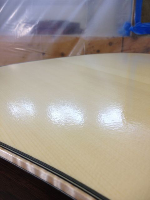

Ok, so here we are after the 6th coat. I'm laying out the lacquer at 5mils wet, but it drys with a bit of orange peel. I'm guessing that's because my first two coats weren't the greatest and had a fair bit of orange peel. Comments?

It doesn't look bad. You'll get it on smoother with experience. Don't worry about adhesion or witness lines. It's not an issue.
I'd suggest putting on another 2-3 thin coats, and then knocking it back about 50%, staying away from edges completely. After another 3, sand to 95% level, then spray the last couple thin coats.
EDIT: by "knocking it back about 50%" I mean sand it until about half the orange peel is flat, not sanded until half the finish is gone...
