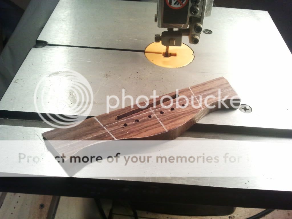

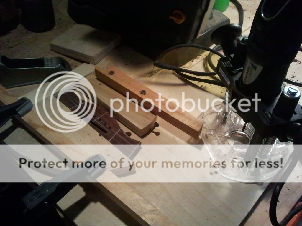

I've been trying for a couple of weeks now to figure out a way to rout a clean saddle slot for my first build. So far I've wasted 2 rosewood balnks (I ran out of scrap) but on my third try I "came close." I have one more rosewood blank to use but I'm wondering if #3 is salvageable.
I've heard mention that sometimes clay is used to shim saddles when removing a pickup and I'm wondering if that can be applied in bridge fabrication as well?
FWIW here are the issues I've been having:
1: a friend loaned me his Stewmac saddle slotting jig with precision router base but I'm much too wet behind the ears to use it properly. My Dremel's vibrations kept loosening the fittings on the PRB.
2: unless I'm a complete idiot, the Stewmac PRB has no plumb function so I've had to be careful about the right angle to enter into the slot. I don't think it's been a problem but still something to keep in mind. I've tried to counter for that by drilling in the endpoints with a drill on its own "precision" base:
BTW, I ended up not relying on the Stewmac jig in favor of one I'd thrown together out of birch plywood scrap. It's not pretty, but I works to some extent.
3: Since I had issues with the Stewmac PRB I tried going back to the cone base that my Dremel 300 came with but it wasn't up to the task. That's when I saw on youtube that Dremel had its own plumb routing base, which I decided to invest $30 in. Even still, I had issues with the bit wanting to "wander" even if I tried doing shallow passes along the length of the saddle slot. That's when I jury-rigged a second angled guide to keep the base from wandering:
4: I also tried the "conect the dots" approach (as suggested by Stewart MacDonald) but still didn't seem to get a clean line. As the name implies, I plunged a series of dots along the line all the way down to the target depth determined by the stop on my Dremel base but when it came time to "connect" them I had issues. The "front" of the slot is clean, but the back is irregular, as if my base had shifted. I thought I'd taken that into account but apparently not. The bottom of the slot is also a little sloppy in places and I'll need to go back and clean it up, but I'm concerned that my slot will be even wider than the 1/8" I'd intended. Hence my idea about using clay.
BTW, I'd also had trouble drilling all the pin holes in a straight line but I decided to invest in a set of brad point drill bits which along with a digital caliper (IMHO) came out acceptible. After that I decided to move along with roughing out the shape of the bridge using my cheap little Ryobi bandsaw and a coping saw to shape the wings. I still have to angle the back of the bridge and clean up the rough edges and bevels but this is the closest I've come yet:
Anyway, I have one more blank - well actually I also have an ebony blank that I want to use for a future build - but how does this one look for a "third" try? Should I try again?
PS: what's a good "scrap" material to use that's similar to work like rosewood if you think I need to practice more? SPF from the big orange or blue hardware stores is way too soft and oak is way too hard.

For scrap materials similar to rosewood try maple, walnut, or oak.
Use a narrower bit, for a 1/8" slot use a 3/32" bit, and for 3/32" slot use a 1/16" bit... so on. Cut the initial in the middle and clean it up by moving it to one side then the other. I also had good luck chucking a small endmill in a drill press and milling it on it. I am not using any fancy jig, just enough guides to get the slot routed and I used a laminate trimmer to do the actual routing.

+1 to all that, especially minimal jigs & laminate trimmer. The bearings in most dremmels are too sloppy for real precision work.
edit: by the way, the saddle slot should angled back a few degrees, close to bisecting the breakover angle at the saddle.

To the original poster, I truly wouldn't trust my dremel used as a router in such a wide slot. It is asking a lot for such a underpowered tool especially in cases that require precision as well. If you don't have the ability to get a larger router then I would suggest using a smaller bit as well.

Yeah, I see that the Dremel isn't up to the challenge. I think I'm going to use it for inlay work only - when I get to that point. In the meantime I'll see if I can get access to a router.

Yes Neil, you have made the same discovery as all of us - dremel tools are not up to the task of routing a clean saddle slot. A laminate trimmer will do it well. But the best setup is one that allows you to plunge into the job, and a router is best for this. You have the right idea with your jig that places the bridge on a lower level and then runs the cutting tool on a solid surface above and parallel. You are also onto a good plan having a solid fence on both sides of your tool, so that it has nowhere to go but in a straight line. You can also set a stop at each end of the travel to avoid cutting too far (this can be as unsophisticated as a small nail partly driven into the end of your jig).
To cut a sloping slot just put a popsicle stick flat under one edge of the router/trimmer. It lifts it up about enough to slant the slot by 2-3 degrees towards the tailblock.
