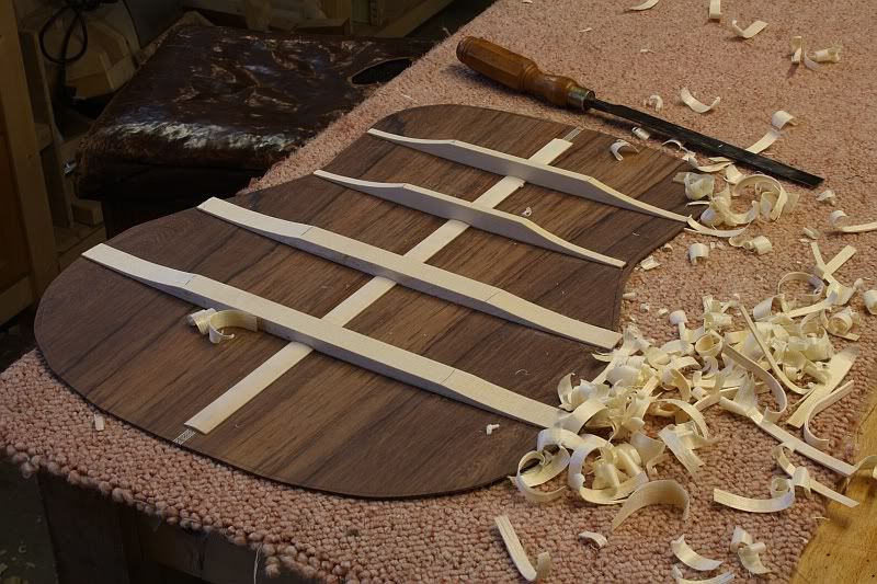

Am wondering if there was a faster way to shave braces.I used a marples 1in bluechip old chisel ground to 25 deg (like in the gore book) in conjunction with several flat swiss 1in 3/4in and 1/2in # 1 carving chisels it seems slow to me .What are you using, and does it go very quickly. signed very impatient wow7-eyes Thanks.

I think a chisel of some sort is the fastest but it's a matter of technique. I'm slow because I'm not that sure of my ability & don't want to damage the top or go too deep on a brace.
I saw a woman at the Martin factory who looked like someone's grandmother take huge but controlled cuts with a bent chisel. I'd say she was at least 5x faster then me at my best.

My main tool is a 1" chisel with the corners rounded off to prevent marking the top if it slips. I picked this tip up at a workshop at the 2011 A.S.I.A. I also have a couple small planes that are used a bit, but the chisel gets most of the work done.

Since publishing the book, a friend made this paring chisel for me (Japanese chisel for comparison):
The blade is a full 10" long, cut from an old circular saw blade used by loggers in the bush around the turn of the century (not the recent one). It has the reach to be used bevel up or bevel down almost anywhere on a guitar and is definitely my go-to chisel for all sorts of things. The blade is 18mm wide.
