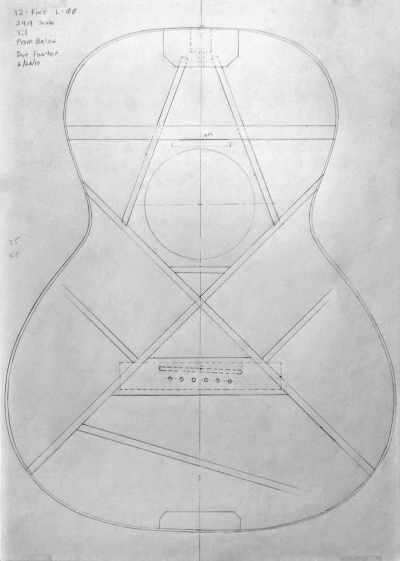

Casey Cochran wrote:
<snip>
I will be working from the Grellier L-00 plans. Is it okay to simply shift the soundhole and X brace south without modifying the angle and brace dimensions? Does anything in the upper bout/UTB need to be addressed? Thanks in advance!
That sounds like a good start. Here's 12-fret L-00 I built a few years ago. I would guess something between this and the Grellier plan would get you started on the layout for the components on the top.
It's just a snapshot of my drawing, not 1:1 as stated on the drawing.
Pat

Thanks, guys. Pat, using an A-frame for these builds makes perfect sense and I wouldn't have thought of it on my own. Thanks!
