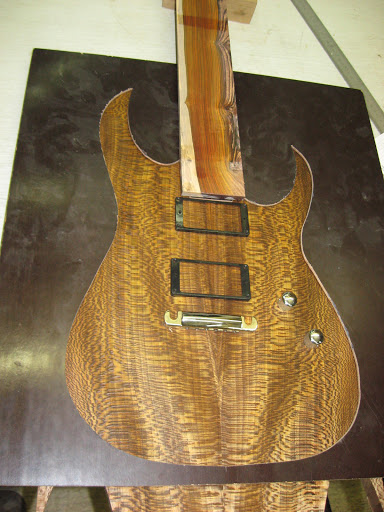

I also like this stuff, but haven not finished one yet....
https://picasaweb.google.com/115793185519493121307
/FiguredPlaneTreeSnakeskinPlataneSchlangenhautElectricGuitarBodysAndTops
