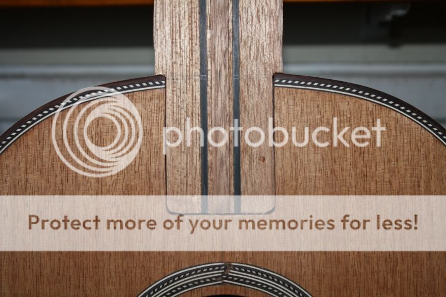

I have a slightly different take on A braces and the head block and UTB, one that would probably be understood by those that also make classical guitars. I inlet all of the braces on my tops to the X brace, making a unified bracing system rather than discrete separate braces. The A frame braces are also inlet to the headblock, (as is a neck extension) but they pass through apertures in the UTB uninterupted. The UTB being treated more as an open harmonic bar.
The the neck extension is inlet into the block as well, the FB being glued to this extension, not to the top.
