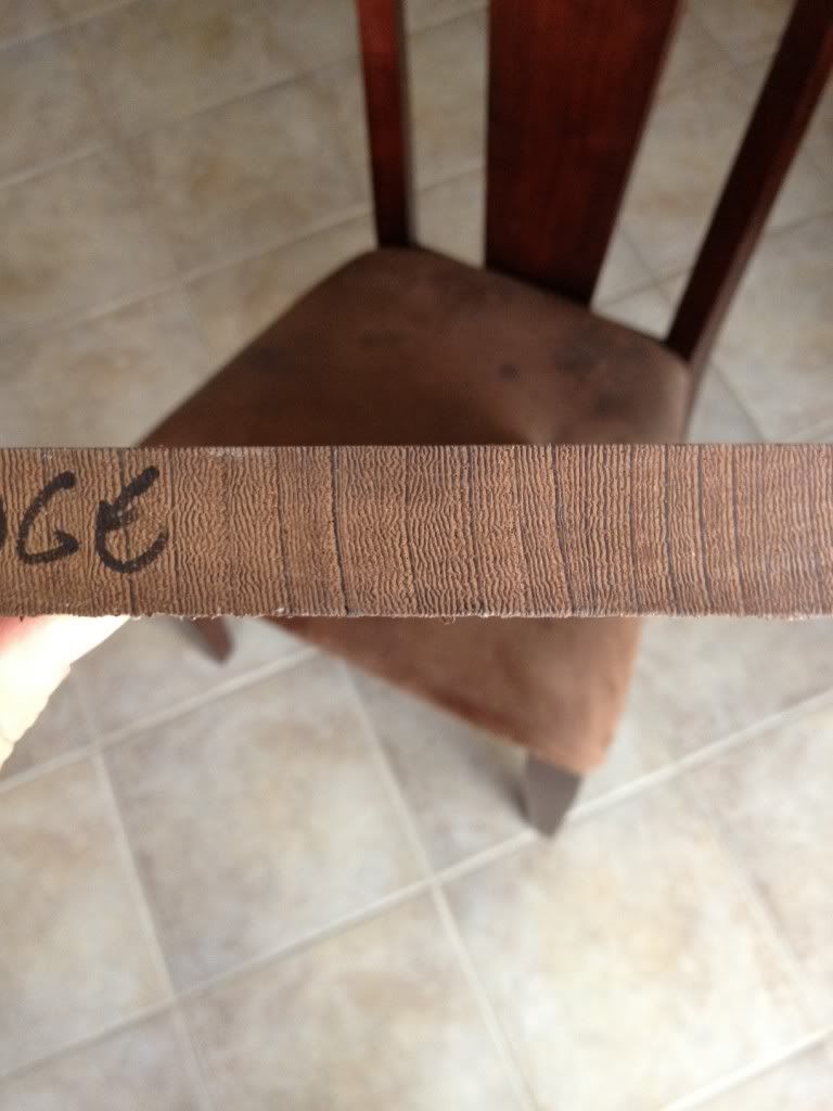

Uh oh. Me thinks maybe I used the wrong term for how this wenge I purchased was cut. Maybe it is rift sawn. Here's an image I took :
Is that rift sawn, and do you think that will be ok for the bridge???

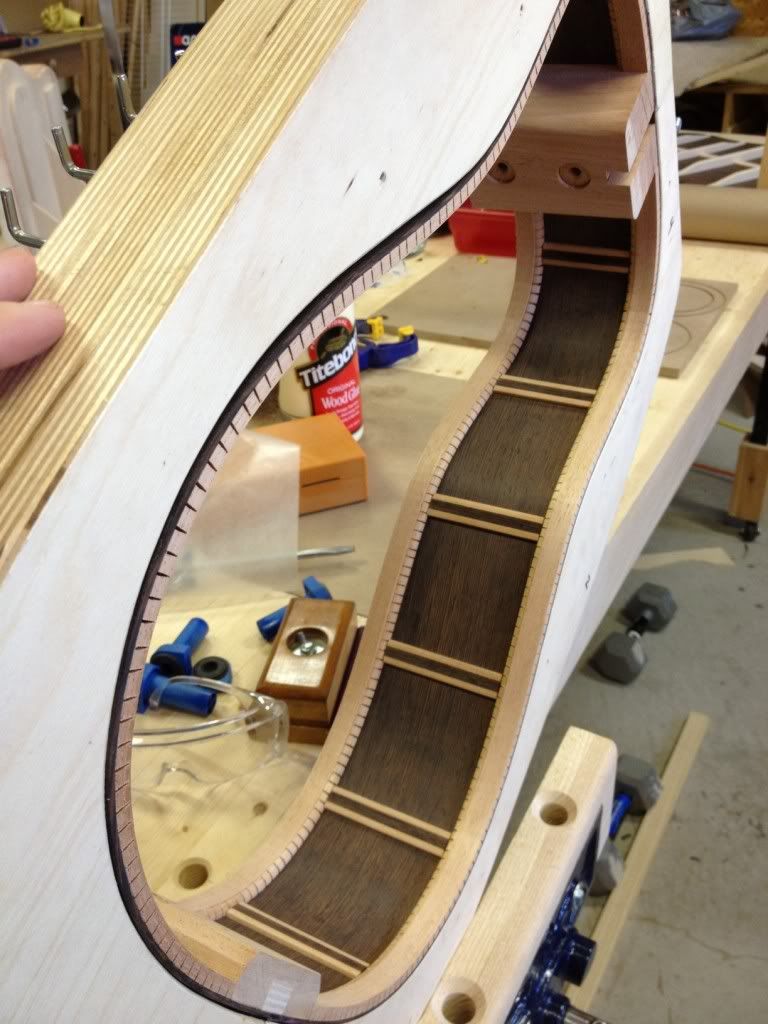

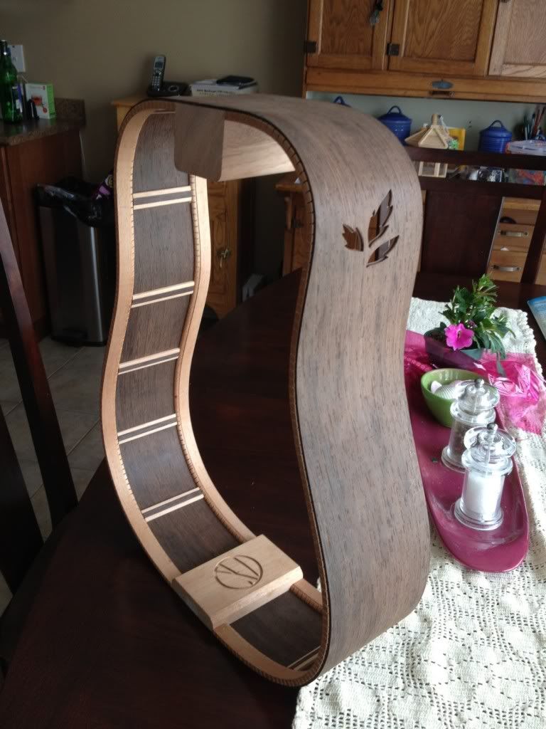

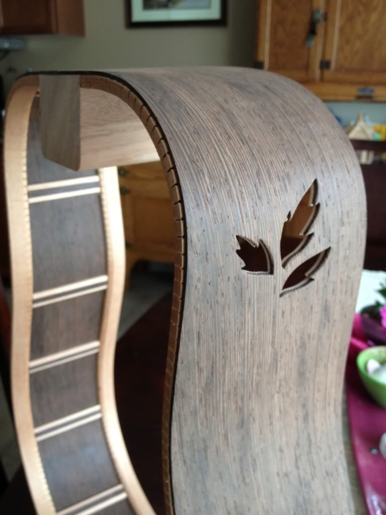

And here are some pics how she currently sits :
Like I said, this is my first guitar I've made not from a kit. I decided to try my hand at a sound port and I think it turned out pretty good!

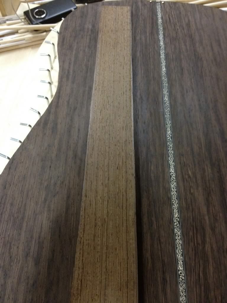

And here I've thrown in the colour difference between my back/sides and the new piece of wenge I've cut - you think this will darken up to match the back/sides?

That's a quarter sawn piece, and yeah it's pretty light. I've never seen wenge that light. I don't know anything about it darkening though. My local lumber store carries all the wenge u can dream of, and rich rich chocolate brown like your back and sides.

Hmmmm... I might have an answer to the colour issue. I did some quick reading and apparently when you apply oil to wenge it goes almost black. I'm going to try some fingerboard oil on a scrap piece and see what happens.

I've had several wenge boards that were light colored when freshly cut that oxidized to a nice dark brown over time... if you don't have to build with it right away stick the board out of the way but exposed in a well lit room (but out of direct sunlight) that gets decent air circulation. After a few months if the exposed sides are darker than the bottom, then it will likely darken to that nice chocolate wenge color eventually.

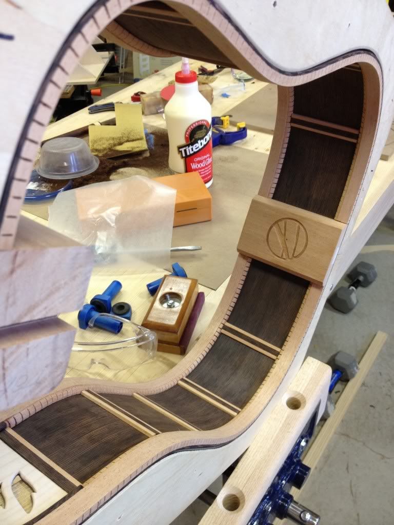

Can I ask why the enormous neck block?
Another day, another dollar.

I'm wondering about the grain orientation of your neck and tail blocks. the shrinkage over time could cause some problems.

Mr Shaw - as this is my first scratch built guitar, I'm still colouring inside the box. I have a guitar plan which calls for a next block this size. It seems a bit large to me, but I wanted to follow the plans. I thought of making the neck block lighter, but I'd be kicking myself if I screwed up and made it too small/thin/light. I'll experiment on my next guitar.
