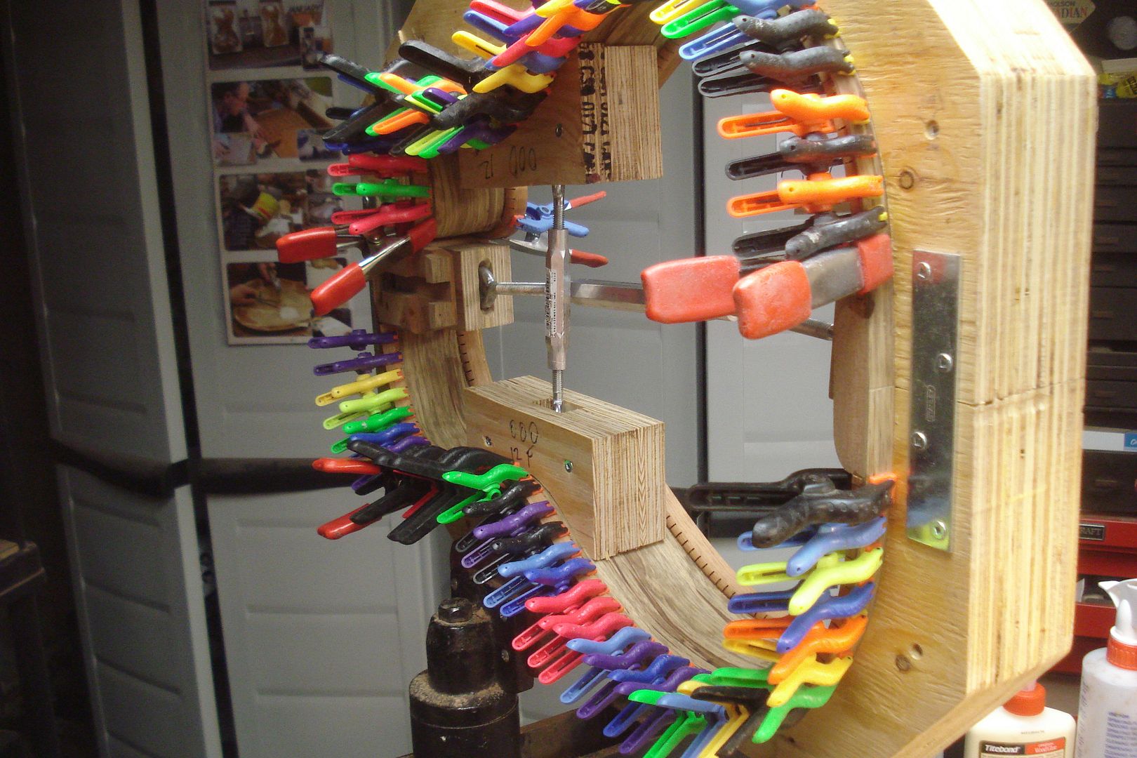

You can use utility grade fir plywood, I have several guitar molds built from this and they work excellent and are much lighter. Mine are all 4 layers of 3/4 ply as I like the extra support. My dreadnought mold was the 1st I did with the cheaper ply and it has been used for 5 guitars and stood up well.
Here is a shot of my 000 12 fret mold
Fred

Here's the starting array of molds and templates for my latest build, which is a baritone using my own "odalisque" shape with Jumbo dimensions. My molds are made from either five plies of 1/2" or 3 layers of 3/4" Baltic birch. They've evolved to this point of not needing the perpendicular turnbuckle between the blocks, which I always found to be a huge hassle. I also make blocks that screw onto the ends of each side, that effectively become cauls for gluing in the blocks, and also takes the weight of the mold off the very fragile rims before joining the plates. I also like that they keep the sides registered to a sort of datum, in case you want to take out the rim assembly for example. It's easy to relocate.
You can also see the side bender form I made from the drops and some steel rod. I also make a dedicated waist caul for each shape, along with side templates and bracing templates I draw out in Rhino.
