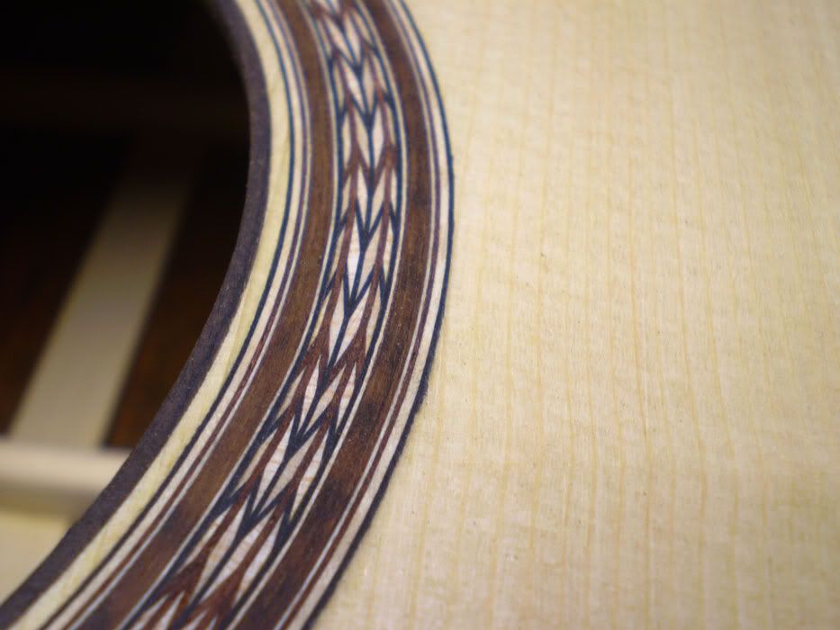

I make my own and always make a bit extra because as you said, it can be difficult to bend cleanly. I use titebond II or III and bend slowly and on a fairly high heat on the pipe. I would say heating up a large area and then focussing on the bend makes all the difference. If I focus on one spot at a time it almost always breaks. That is the nice thing about the electric LMI bender, it has a nice flat-ish area on the side.
Here is my toughest challenge, a double row glued up and then bent as one so all the points lined up. Took a couple tries. I'm not sure I would try it again but at least it worked once!
Burton
