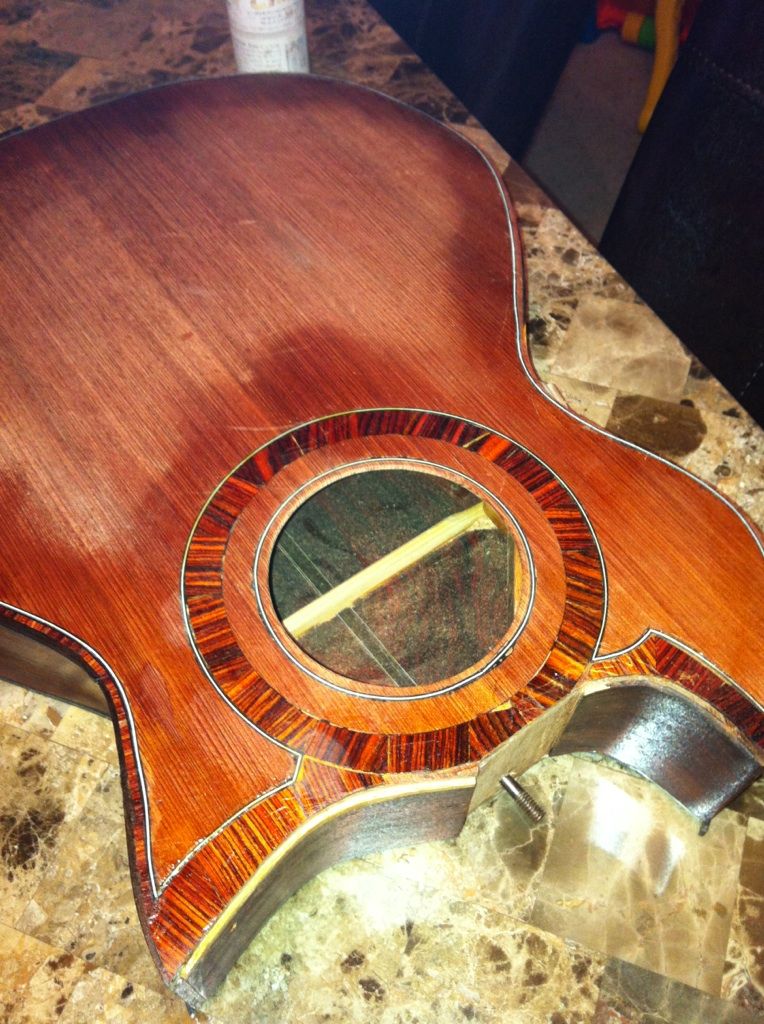

PostPosted: Tue May 22, 2012 10:10 pm
Joined: Fri Jun 17, 2011 8:35 pm
Posts: 363
First name: Maks
Last Name: Lavrov
Here's one I'm working on right now. Sorry it's in VERY rough shape and I just installed half of the radial purfs to show how it should tie together at the end. The photo is from a phone so sorry for the bad quality Image
