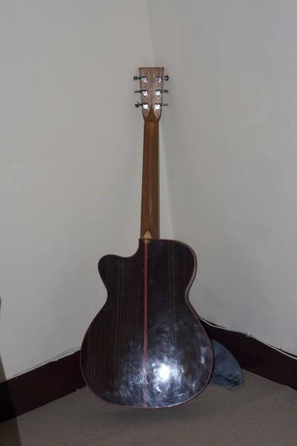

#3 is complete.
OM cutaway body
German Spruce top
Coffee Estate rosewood back and side
Curly maple binding dyed red
Khaya mahogany neck
Ebony bridge and fingerboard (as usual)
abalone dot inlay with abalone headstock inlay, and abalone rosette
French polish on the body, and tru oil on the neck, and lacquer on the peg face
Still haven't installed an end pin.
This guitar did not turn out as good as I like, there are still some yellow stains on the soundboard because I had removed a rosette that was gouged and too thin, so this is more like an experimental build than anything. Sounds pretty good though, not big and boomy like a Dreadnaught but has just the right balance between good responsive treble and bass. I think I want to build more OM and other smaller bodied guitars. An added bonus is that its so much easier for someone like me to play it. A dreadnaught just feels like it's too big.
Here are some pictures:

Looks good to me and I don't see any yellow staining. What finish did you use?

Its french polish shellac.
It does not show on the photograph but you can see it in person.

I took a second look at your guitar pics and I noticed something I can't ignore.
Do you normally take your pants off before photographing your guitars? Wait...don't answer that. I am just thankful that the pictures do not show a reflection of a naked Tai Fu on the guitar! laughing6-hehe
Thanks for getting the angles correct so that you didn't show up in the pics!!
How did you do the binding on your headstock? On the guitar or off?

It's a spare pant that happens to be in the room...
I bound the headstock at first off the neck, but found that I had serious trouble keeping everything together, so I routed them off and redid it, on the guitar.
I had serious issues with the binding and I think it has to do with the veneers I used as purfling, it's just too damned stiff and so it didn't want to stay on the body itself, giving me all sorts of gaps. I never had problems like this before.

Very nice guitar Tai, the bound headstock is very nice, what is "coffee estate" rose wood?

It's basically "Indian Rosewood" (I say this because it is the same species of rosewood as EIR) grown in Indonesia as windbreakers for coffee estates. It's also known as sonokling. Got them cheap, around 20 dollars for the set. I wish I can get more because for some reason the supplier who sold me this set is suddenly "busy".

I am not going to recommend dyed maple binding to anyone... too hard to do without sanding through.
Next time if I want a red binding, I will go with bloodwood.
