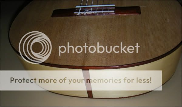

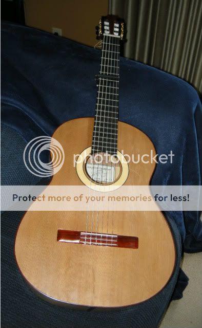

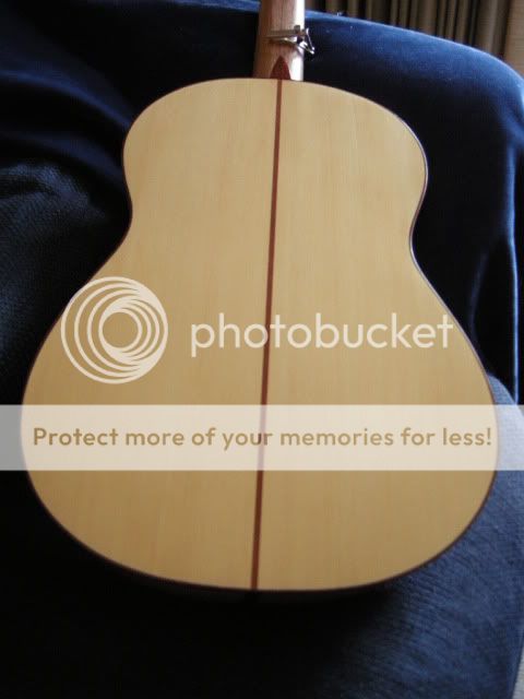

Here's some pics of guitar #1!
I posted a link to a video a while ago with a list of woods, but here they are again:
top-red cedar
back and sides-yellow cedar
neck-khaya (?) with carbon fiber reinforcement
fretboard-ebony
bindings and brige-padauk
The finish is French polish/spirit varnish.
She's been strung up for about a month now and apart from mellowing in sound a bit I'm still really pleased. Very easily heard over dancers and great for accompanying cante.
I can't express how much the generosity of more experienced builders helps those of us starting out. Many thanks to everyone here again for advice along the way!
Jake.

Sweet~!
PostPosted: Sun Mar 25, 2012 6:04 pm
Posts: 1958
Location: Missouri
First name: Patrick
Last Name: Hanna
State: Missouri
I think it's sweet, too.
PostPosted: Sun Mar 25, 2012 6:08 pm
Joined: Tue Mar 10, 2009 7:11 pm
Posts: 333
First name: jack
Country: usa
nice looking guitar Jake....
PostPosted: Sun Mar 25, 2012 6:26 pm
Posts: 855
Good looking guitar, Jake! Nice clean work. It's good to see another flamenco enthusiast on the forum.
Best wishes,
Max
Max Bishop
Brighton, Michigan
PostPosted: Mon Mar 26, 2012 8:14 am
Posts: 3031
First name: Tony
Last Name: C
City: Brooklyn
Really nice work!!

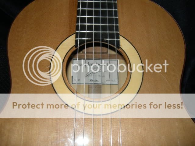

What is the rosette? It looks really cool.

Thanks all! I think she's pretty sweet too. :D
Stephen, yep I'm a big fan of flamenco too! Sort of semi-pro playing locally. laughing6-hehe I really enjoyed your build log about the Casa Ferrer-inspired guitar. Granada-style guitars are some of my favourites. I built the blanca in the Spanish style as well but with a solid mold that fit onto the soleara. Mostly hide glue throughout as well.
Jfmckenna, glad you like the rosette! It's yellow cedar from the back offcuts with the borders in black fiber veneer from LMI. I like the strong visual border the rosette has but I'm not likely to use the fiber stuff again. It planes and scrapes nicely, but is a PIA to cut into strips. Like cutting thick rawhide.

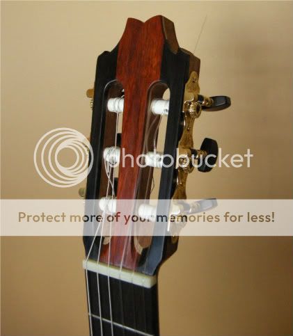

Can you guys tell that this is the guitar I posted the "Headstock Woes" about a while back? :lol:

Jake;
Very nice !
I especially like the head design.
Thr Reyes plan is very good.
