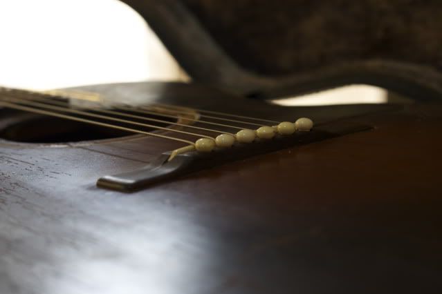

I have a 1930 (I don't remember the year, the FON number begins with 7 and is 3 digits), with a loose bridge... here are some photos:
First, I need to remove the through cut saddle, so I soak the joint with water and apply a wet cloth and soldering iron to slowly steam it out:
Then protect the finish with aluminum foil so that the heat does not damage the finish:
15 minutes later, the bridge is off. I need to let the bridge cool for about a day before going any further since the heat will have warped the bridge:
More to come...

The foil didn't really protect the finish did it?
Judging by the spot in front of the bridge it just conducted the heat thru

When I've used the heat lamp method I've used thick poster board under several layers of foil to avoid that.
Yea, I'll have to do a little finish repair there... but the spot was fading away because I think a little bit of moisture was somehow introduced into the area and as the moisture evaporated, the spot was going away. Luckily since the finish was already in such a bad shape, I can blend it in.
I've never managed to heat a bridge off without some kind of finish damage around the bridge... when I tried the cardboard shield the heat still managed to conduct through the foil and cardboard, and I found the key is to make sure the iron does not touch anything besides the bridge, but given the height of the bridge, there isn't much I can use to shield the guitar without making it higher than the bridge.
I haven't managed to find any heat lamp since incandescent lights are difficult to find in Taiwan, the only thing I can think of at the moment is those 500w halogen lights but I'll need some time to rig them to safely work with guitars. I was thinking of getting some heating blankets for repairs but noticed LMI no longer carried them! Don't tell me they're discontinued like the Wagner Safe T Planer...

I use some sort of cloth fire retardant material available at a local hardware store. You can cut it with scissors to fit what ever application as necessary.

Tai Fu wrote:
... I was thinking of getting some heating blankets for repairs but noticed LMI no longer carried them! Don't tell me they're discontinued like the Wagner Safe T Planer...
I was just looking at them the other day but didn't get one yet. I've had good luck with both the iron or the halogen lamp. Double layer of cardboard covered with foil. Last bridge, insulated with a wadded up bath towel. I put a wet paper towel under the iron to keep it from scorching the bridge. Steamed it off in a matter of seconds.

Mike Lindstrom wrote:
Looks like they're in stock now. Maybe there was a glitch in their site? Check for SPBL1
Yea, I never did get one just because right now I barely have enough money to pay rent and bills, and needed what I have left to buy air conditioning units. I thought those heating blankets are better to heat bridges off since I can concentrate the heat only on the bridge rather than risk melting the finish around the bridge. I think next time I'll try wet towels on top of the bridge to see if I can heat it off faster with less damage...

Taped around the intended site of the bridge to create sort of a "dam" so I don't get lost in the liquid glue... then leveled the inside of the bridge and glued and clamped it up...

What type of glue are you using?
Hide glue

Ok the repair is finished...
