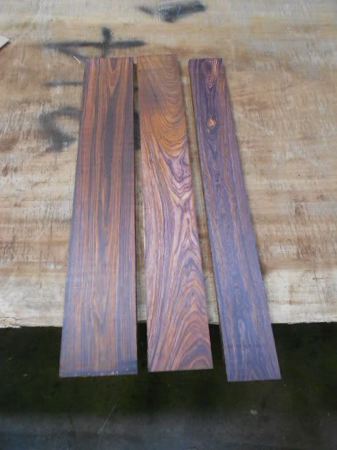

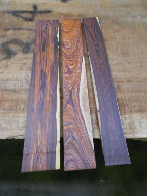

I'm looking at 2 pieces of cocobolo for my build, and I'm not sure which one would work the best as far as being easily bent as binding, and strong enough to use as a center laminate for the neck. Here are my choices:
FRONT: Trying to decide between the left, and middle piece
BACK: Trying to decide between the left, and middle piece
Opinions please. I like the color of the middle one, but the crazy grain scares me a little bit.. Should it?
Jason McGowan

i don't think i would use it in a neck; it doesn't seem very stiff
edit: upon reading, it seems like most people disagree. my impression (last night) was that my piece did not seem as rigid as a comparable piece of ebony/rosewood/cedar/spruce
Yea, another one of my dilemmas. I really don't have any experience at this sort of thing, but logically it seems that the one on the left would be the most structurally sound piece of wood. Am I right in this assumption?

i edited my post. i am a total amateur so i shouldn't be commenting. but to me, it doesn't seem as stiff as some other woods at this point

Filippo Morelli wrote:
Use anything you want in the laminate.
As for binding, once you bend it, anything works - binding is a small piece of would with a significant gluing surface. It's not doing anything once it is installed.
Coco bends pretty easily, like many rosewoods. As for color - pretty irrelevant as it will oxidize. Figure (ink lines) will show to some degree. If you are doing a standard guitar body, I can't imagine grain orientation and runout will cause an issue. If you start doing strange bends ... maybe. My 0.02 cents.
Filippo
Great info Filippo! Thank you.

There's no published Modulus of Elasticity for Cocobolo, but it's Janka (hardness) rating is 1010. Compare that to around 800 for Mahogany, 1010 for Walnut, and 1450 for Hard Maple. It's well-tested even for a one piece neck. As a laminate? No worries.

Coco works well in a neck as a laminate piece(s). It bends and works fine for binding. The choice of what to use for a particular part of the build is up to the builder.
