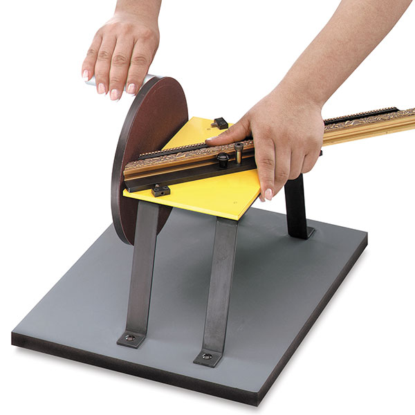

One of these should be easy to replicate:
http://www.dickblick.com/products/logan-precision-sander-elite/?wmcp=amazon&wmcid=feeds&wmckw=17187-1001

I hadn't seen that Logan precision sander. Could MDF be used to make the disk? The rest of the design seems pretty straightforward
