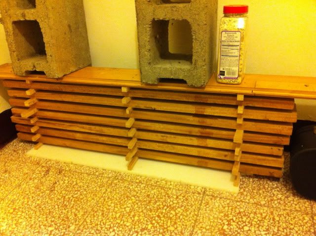

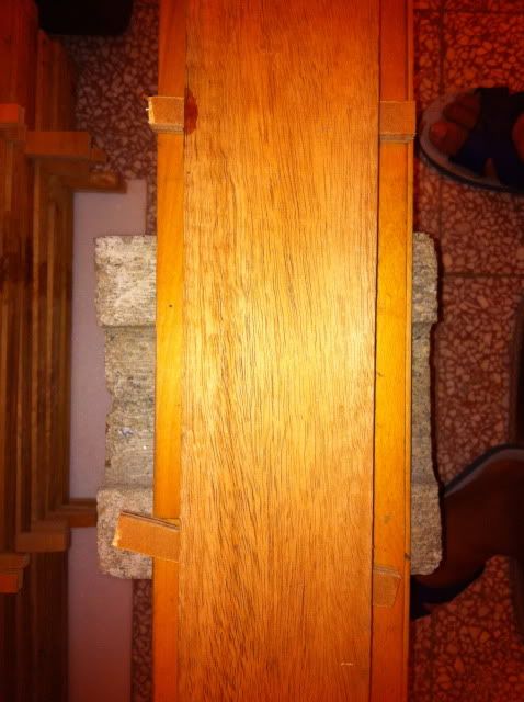

I just want some confirmation... I got some Honduran Mahogany from a domestic supplier. The guy calls it Mahogany Swietenia macrophylla, and I just want to make sure it is the same stuff... I got about 7 planks of 1"x4"x40" which is enough for a neck. It was fairly cheap, about a little less than a similarly sized neck blank from LMI minus the shipping. The quality (as you can see) is not all that great but will look good when clear coated. It's fairly light, almost 50% lighter than my Khaya blanks, but the color is also fairly light too.
How can I tell between Khaya and Honduran Mahogany?
Here are some pictures:

Khaya is a little bit harry looking.Almost like the grain is raised.I`ve never noticed this with Honduran.Hondo also seems tighter grained,and a little darker in color,To me eyes.

I've used thousands of board feet of Honduran and half that of African over the years and from
a photo I'd say it's impossible to tell.
I have a project right now where I've mixed the two and some of the pieces could be either.
Generally speaking, though, African is sold rift sawn and the grain is rowey. - but not always.
Also, and again in general, it tends to be not quite as red as Honduran and the grain lines tend
to be shorter and more pronounced.

Honduras mahogany has storied rays. In other words, the rays are in horizontal lines that produce ripple marks on tangential (flat sawn) surfaces. The rays appear as short dark lines on the flat sawn surfaces. This is best seen with some magnification.
African mahogany (Khaya) has staggered rays that do not produce the ripple marks.
There are other tropical American woods that resemble mahogany (and also have ripple marks) but they are considerably denser than true mahogany.

Now I am even more confused... it's like both species exhibit pretty much the same thing.
But seriously though I am beginning to wonder the viability of those blanks as necks... most of them have light colored stains, I don't know what. A couple has black lines through it that looks like spalting, and all of them have tear outs from the planing operation at the factory... so it could even be Philippine mahogany for all I know. Problem is it's almost impossible to tell the difference without a DNA analysis.

PM doesn't smell anything like genuine mahogany. The 'fuzziness' that has been mentioned is characteristic of most PM and African mahogany, and is not normal for Honduran. This fuzzy texture is most noticeable on rough sawn surfaces, or surfaces that are coarsely sanded. Once you know what to look for, it is pretty obvious. No need for any DNA tests.
