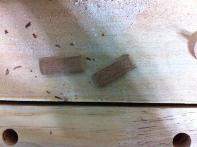

After having the workbench built I started work on reinforcing the neck.
First I tried to build a router jig that would allow me to route this thing without error, but as you can see, the router bit is too short, so I ended up having to do this:
It works fairly well, in that I can keep the router bit fairly steady with this setup even though it looks a bit scary.
Here is the first slot:
Then both slots:
At this point I started fitting the mahogany plugs:
I've decided to use hide glue because now the joint is fairly tight and not sloppy like last time:
Time to start cooking:
And finally here is the plug inserted:
There is a very small (.005") gap in one of the wood plug, if it becomes a problem I will fill it with CA.
