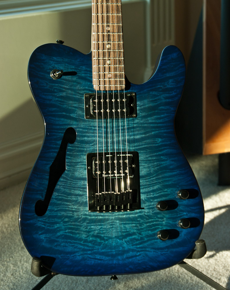

I shoot 3 to 4 thin coats a day on consecutive days. Given my schedule though, I usually end up with a day or two off in the interim. For an acoustic, I build up about 10 coats on the top and 15 to 16 everywhere else.
I have had very good success with Em1000 in shooting color, having done two bursts, and I am shooting a bursted LOO next week. I like it as I can use a higher color ratio than with em6000. I usually put down a couple of clear coats, then follow with the color, shooting it with such low volume that it is practically going on dry. Once happy, I top with a dozen coats of em6000.
With these guitars I hand rubbed the base color, but then sprayed the darker color around the edges.
Ken
