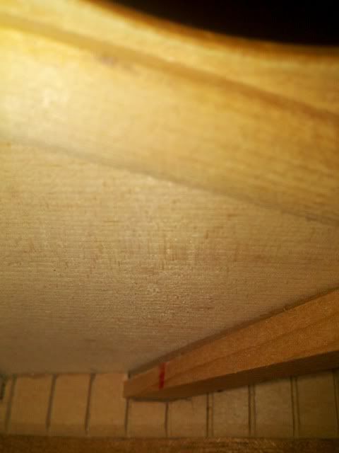

As much as I want to dig into this and get going, I'm having to restrain myself and force myself to take my time and be patient.
Here are a few more pictures.
http://i1114.photobucket.com/albums/k52 ... 1318005600
That is the treble side x brace in the upper bout. It is actually the leg that cracked. To me the pockets in the linings are too big and didn't provide any support. But I am not hugely experienced, so your opinions will be well-heeded.

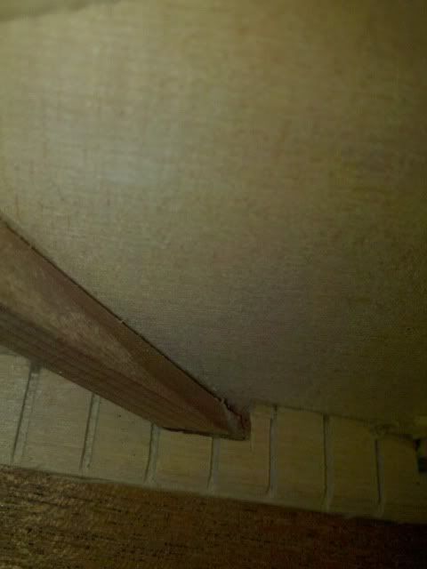

http://i1114.photobucket.com/albums/k52 ... 1318005363
This is the bass side upper bout.

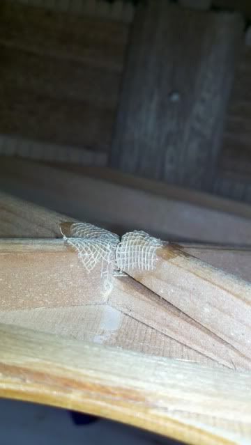

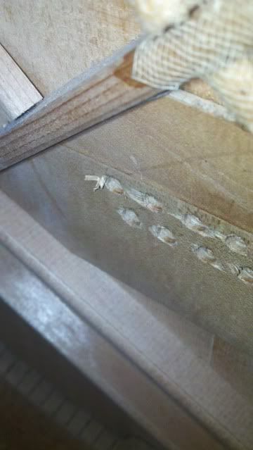

A short update and thank you with some pictures.
I decided to heed John Arnold's advice and try to do it all through the soundhole, remembering this was about gaining repair experience too.
I spent about a week trying to humidify the guitar somewhat. It was in a storage unit when I bought it, and our summers here are well over 100 degrees with very little humidity.
I made various clamps and watched/read as much about this as I could. Overall I couldn't be happier with the progress. I still have some things to do, and I will update those as I complete them.

I definitely will be filling in the gaps in the lining under the x brace legs and the UTB, as well as capping the x brace.
