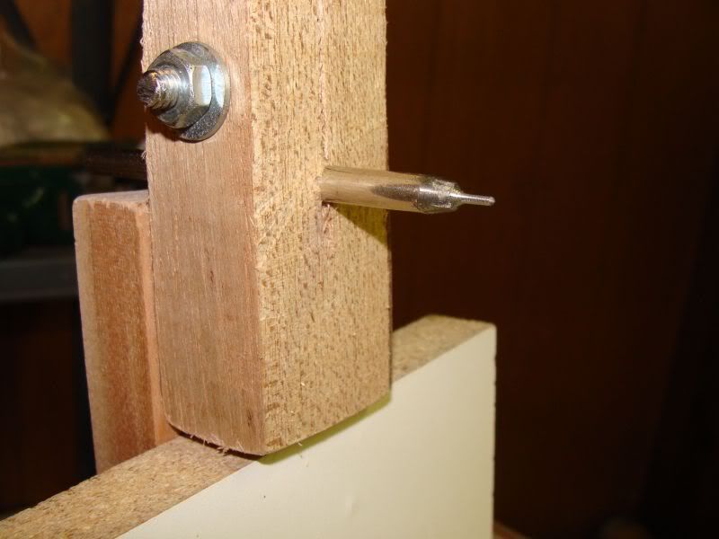

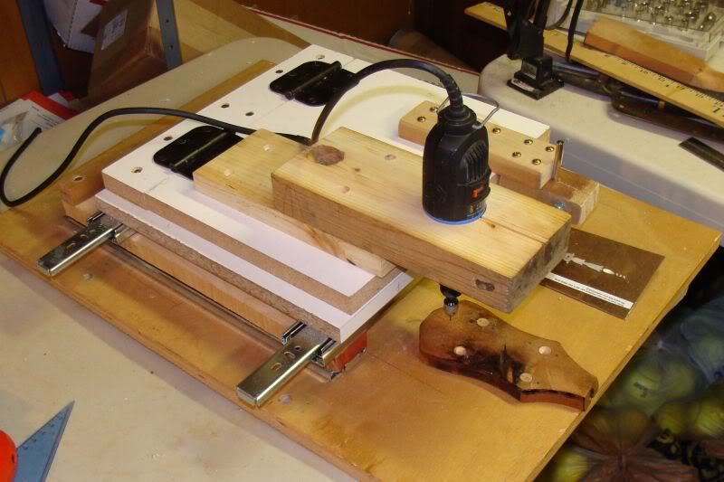

Here's my take on a duplicator/pantograph/copy carver for doing inlays.

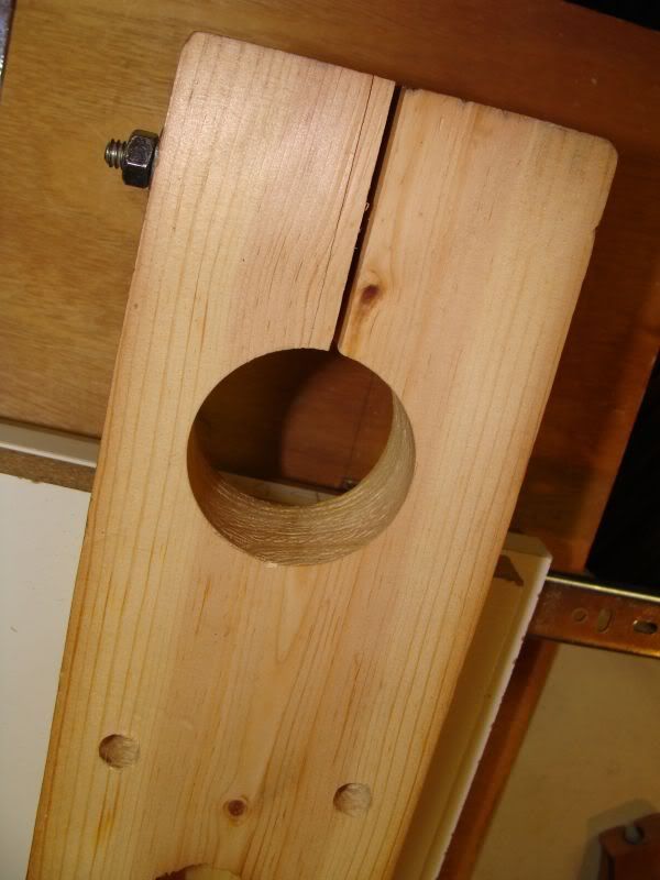

It's loosely based on Keith McKenzie's rig. I made a few changes to Keith's design to go along with my thinking on the subject. I saw no need for the cutter arm and the stylus arm to be separately hinged, so I screwed them both to one plate and needed only two hinges. The only parts I bought for this were two sets of 14 inch drawer slides, two hinges, and a couple of cans of Friendly Plastic. The rest of the parts came right out of my wood scrap box and metal junk box.
The Dremel body was too large for a 2 3/4 in. Forsner bit, but too small for the 2 7/8 bit, so I added about three wraps of painter's tape and it fit the larger hole.
The stylus was made from some 1/4 in. rod that I ground down to a 1/16 in. point because I use a 1/16 in. bit in the Dremel.
After I played with the Friendly Plastic and one of my inlays for a couple of hours and made a pattern, I did one test routing using double sided tape to hold everything down. (Remember to put the pearl piece backwards into the plastic, so the pattern comes out forward.)
Half way through the job the tape started loosening up, so I'll have to figure out how to hold the pattern and the thing to be inlaid so they won't move - clamps, screws, hot glue. But I am happy with the way the machine (?) works so far.
This will make routing for inlays a little easier and more accurate for me. But there is still some hand works to be done after this machine does it. The square corners still need to be cut with a chisel because the round bit leaves a rounded inside corner.

Strips of carpet tape(the kind with the fibers in it) near the edges will hold things down pretty good. I say strips near the edge so you can get a putty knife in there to break it loose. Making a clamp set like machinist use out of wood might also work for certain situations.
Nice take on the duplicator. As long as it does what you want it to do is what matters.

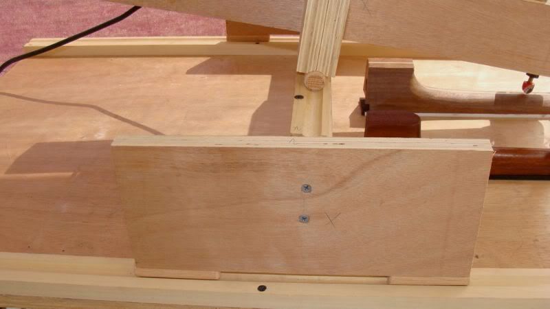

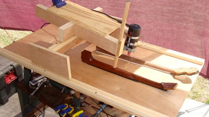

Here's my take on the duplicator. It's big enough for neck carves and bodies.

Mark, I like it and is along the lines of something I have in mind to build.
Do you also carve the heel with it? If so do you do it in that position or have you made a revolving vise that will rotate the work pieces around the long axis?
Chris, I don't carve the heel with it, just use it to replicate a neck carve. Although it could be used to do that from the side held in a clamping jig if desired. The height of a heel would be too great for my trim router but a pencil grinder would work as is without a jig because my table distance to the sliding platform is over 4 ".

Mark, where is the z-axis? (how is it implemented)

Mike, the hinges in the back like Keith MacKenzie's. It's just basically a little larger scale.
Mike, As Chris has said, this one is is done with hinges that are racked to take up any slop and work good. However i'm going to improve on this design by useing drawer slides so it follows more of an up and down axis instead of the swinging motion there which will go in and out of deep pockets on a straighter axis.

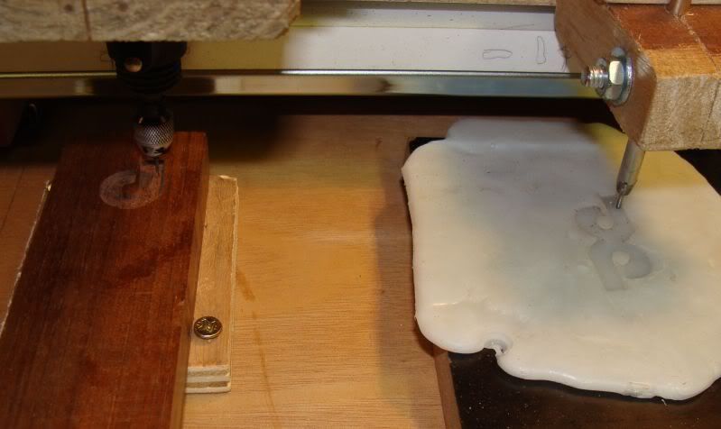

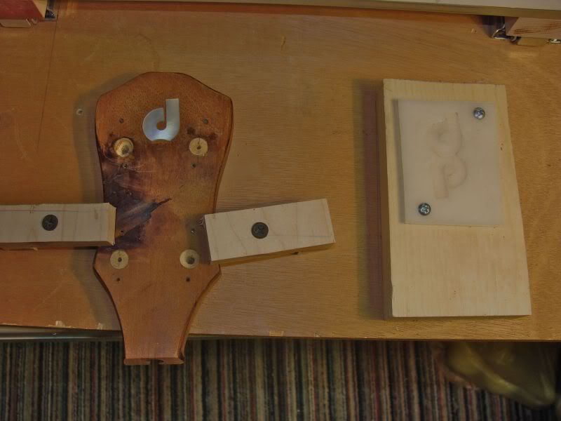

Here's the latest on my McKenzie Machine (inlay copier). I think I've solved my hold down problems by screwing down the plastic pattern and using some L-shaped blocks with screws for the peg head or fingerboard toe be inlaid.
I cut a sample hole in this banjo peg head template. The result was a hair too small for the pearl inlay to fit into, so I reground the stylist tip a hair thinner. I recut the hole and squared off the corners inside the hole and the inlay slides right in. I think it's a winner.
