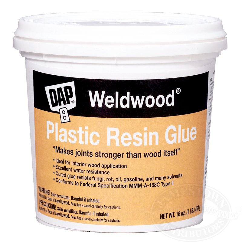

I use titebond for the linings sometimes but to connect braces and plates I use UF glue. Weldwood makes one called plastic resin glue and is available at most hardware stores. It dries hard like hide glue and is easy to mix. It is good stuff, equal to hide glue IMO, although not reversible.
Ken
