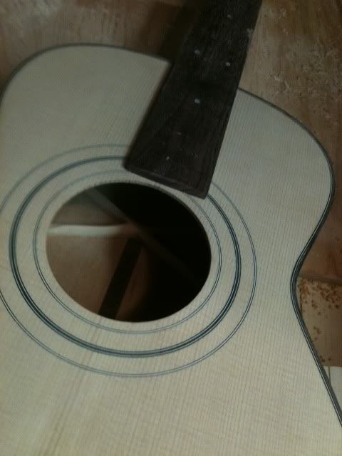

Hey guys,
I dont really post here too often just because I don't really get on my computer often...Although, I always see cool things when I come here so I think I'm gonna work on this. Anyway, to start, I'm Nils Johnson - 21 years old, live in Western Massachusetts. I started lutherie work (cough coughsweeping floors, cleaning shop etc.coughcough) at Downtown Sounds in Northampton just before graduating from high school. I worked there for about two years, then left because I was over extending myself with classes I was taking and working my other (closer to home/better paying) job. So here I am now, taking the semester off and not working(a real job) so I can build acoustic guitars and mandos. Which brings me to this....
Its a 12 fret parlor type guitar, typical martin scale. Mahogany back and sides, spruce top, rosewood binding, and rock maple neck.
The neck rod worked fine in the vice. But now that its in the neck, (which is about 3/4 done so there isnt much bulk coming off at this point) I cant really get much of a back bend with the nut as tight as I'm comfortable tightening. I'm confident the rod works and I'm confident the rod installed properly. I'm guessing the maple is just so beastly it doesn't want to move despite the pressure. Maybe? I've seen tons of guitars with neck rods that don't adjust when doing setups and and other repairs. It just saddens me that its happening on mine. : (
So any recommendations or thoughts? New neck? Overlook it since I can get a tiny back bend?

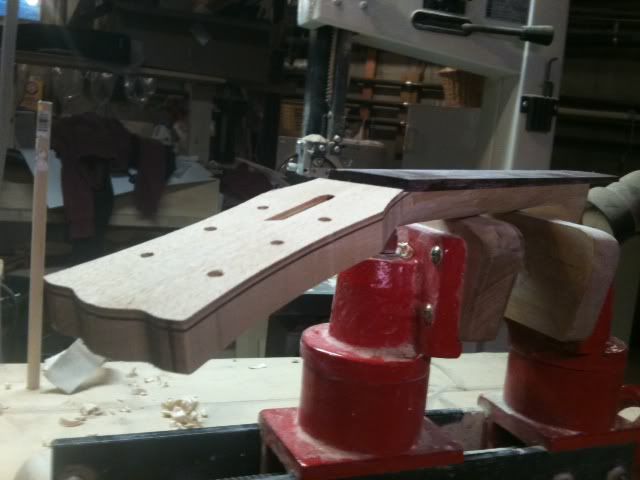

I'm not sure what exactly to call the rod...Its a one way type thing with a steel rod bend 180 degrees at one end and brass block at the other. Its the kind that you should preload a slight backbend into before planing and installing frets. The rod was tapped, and placed in the channel with a thin (~.03") stip above it. Generally, I place my rods in the vertical middle of the neck and use a thicker strip. I chose to have a more shallow channel because this neck is going to adjust from the headstock.

With that type of rod, you HAVE to have it buried deep in the neck. That is why it is not working. I use this type of rod and install it within 1/8" of the back of the neck. I also use a curved bottom channel at the headstock end (about 1/16" curve upward) to get a little extra adjustment in this area.
I would remove the fretboard, pull the rod, route it deeper and redo. At this point in your build, you should be able to recover from this mistake without any evidence in the finished instrument.

And sadly, I've decided to go ahead and just make a new neck. I;ve got the scarf joint and heel blank gluing up right now. I chose to do this because I really didnt want to see the nut any farther down the headstock and also (something I didnt mention before because I was embarrassed) because the the channel the rod is in veers off to the treble side as it gets closer to 12th fret.
Since Im making a new neck, I'm thinking I want use a different rod. What would you guys recommend in this case? (short neck, adjusts from headstock)

Typically this type can be refered to as a Gibson, single action style as they are the ones that made it popluar. Not totally sure but Jim Olson was using the same style through the first 1000 or so guitars (he may still). Barry is right, you have to set those style of truss rods deeper in the neck as well as making the channel taper from the heel up to the nut area (as the neck tapers too), this also helps with the use of the rod. I used this style of rod on my first 4 guitars and it worked just fine, but have since switch to a double action rod as in my opinion, they just work better.
How short of a neck? What scale are you building? I like the Allied two way truss rods, the just work!

This type of rod is used in two versions. Straight rod just buried deep and the curved rod which takes a bit more wood work. The curved rod works much better in my estimation.
