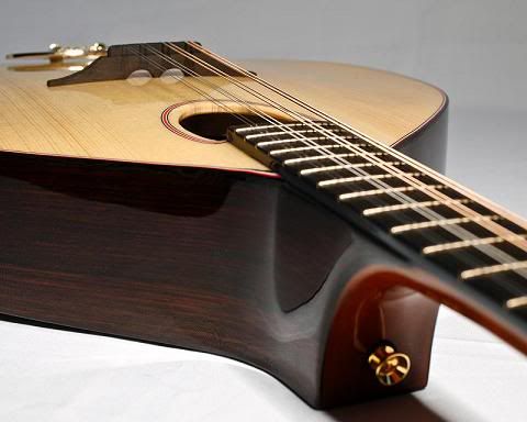

i built this guitar (the woodworking that is) in a 2 days span. Almost no sleep, and working like crazy. Not something I recommend for both you and the guitar.
Wow, How did you do that? CA?

Nope. Used titebond. Vacuum wherever possible as that speeds things up. I just had much multi-tasking and nonstop work.

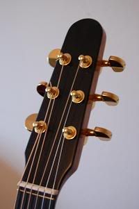

I found myself in a similar situation a while back. Around the time of the crash I decided it was time to make a quicker and cheaper guitar to reflect the times. I agree with many of the previous comments about identifying what you can strip away without making things worse. It actually turned into a very enjoyable process, and a very creative one. It became an exercise in "letting go". What I came up with was my mode S.
Now customers often order instruments (all models) in the model S style as the time/money saving is significant, they then often spend the savings on upgrading materials. It's all rather sensible.
Whilst ladder braced guitars are great ( I love them) they are less commercially viable. A few makers specialise in them, and they are remarkably good guitars, and amazing value, but it's a small market.
Anyway, here are a few images of my model S style - no back binding, only simple top binding, M+T neck, usually no heel cap, fibre head veneer, simplified strutting (mine is normally laminated) Hope they help.
Now, I've never calculated the time spent on any instruments, mainly out of fear!, but the neck joint went from half a day to half an hour, binding takes no time now, and the end result is not compromised. I think of it as the "racing version" of my standard work.
http://www.nkforsterguitars.com/nkforst ... _book.html
Nigel,
Thank you!
This is the type of thing I was looking for/thinking about-although I am going for a more "traditional" looking instrument.
Sort of the "essence" of guitar.
I still think I want to use binding-1 line.
I don't really care that much about how commercially viable they are-I have no intentions of ever making any money at this-I just like to make them.
Now that we know how, the next question is, WHY?? Beautiful guitar by the way. You can't tell it was built in 48 hours.
Healdsburg 2005 time crunch.
