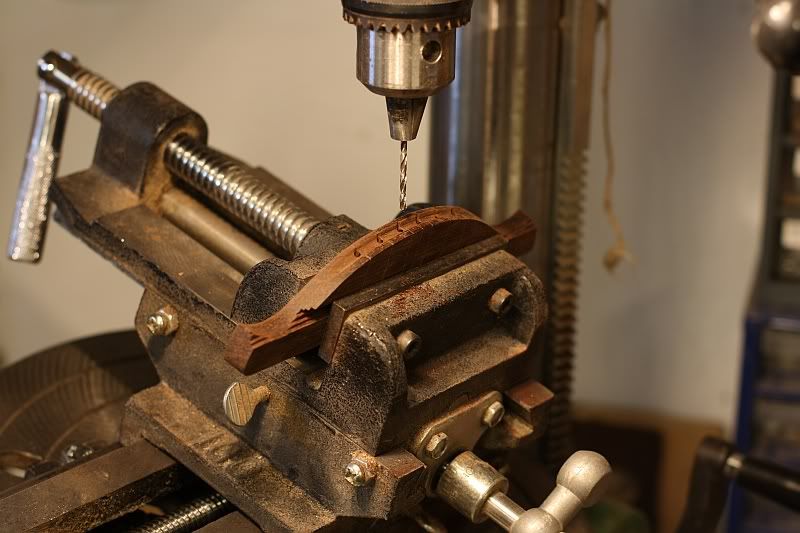

How many of you use a cross-slide vise in your drill press?
It is the closest thing to a cnc machine as I have. My drill press will turn just fast enough to mill wood with a router bit.
X-Y baby!

I got it from Griz. @ $55.

There is a model out there with the name " Palmgren" it is a fairly decent little cross slide vise at a fairly reasonable price . The bottom line is all the cheaper ones are Imports. For an american made , you will easily spend 600-800 dollars .
The shopfox in the pic above looks amazingly like the palmgren , same color even , It is quite possible they have come off same production line .
