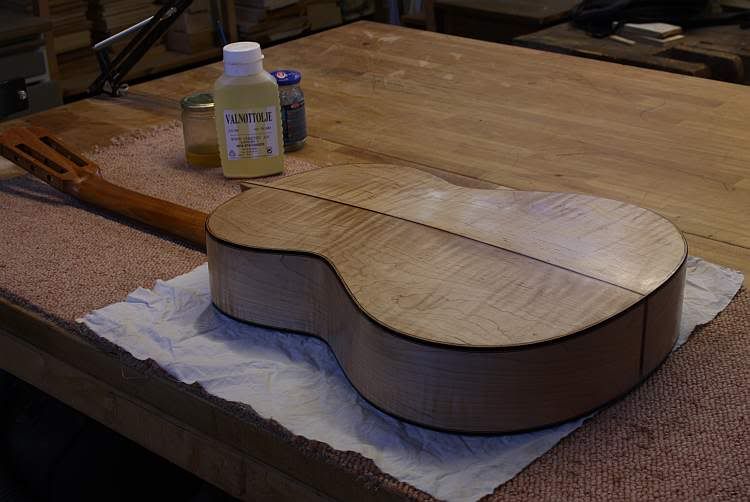

"Norwegian polishing" the $100 classical...
 Post subject: Re: What's Up Doc?
PostPosted: Thu Feb 24, 2011 6:20 pm
Joined: Tue Oct 30, 2007 9:13 am
Posts: 1168
State: Texas
So what's in the bottle? Reindeer oil?
https://www.facebook.com/profile.php?id=100008907949110
PostPosted: Fri Feb 25, 2011 2:33 am
Yup, that's the secret ingredient... ;)

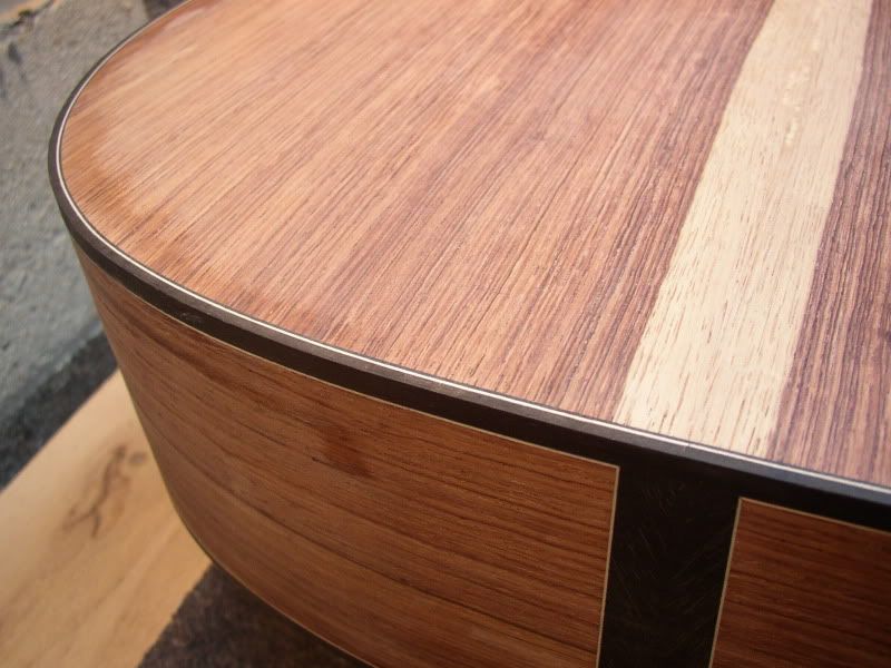

I'm finishing up binding and purfling on the Honduras Rosewood/Englemann OM. Now, on to the neck.
Chris.
PostPosted: Fri Feb 25, 2011 12:54 pm
Joined: Wed Apr 23, 2008 7:16 pm
Posts: 146
Chris.
Now that is purty! like the binding scheme and harmonious wood combo!
