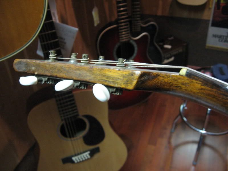

The best nonadjustable wood reinforcement I have used is the vee-shaped bar like Gibson used during WWII. IMHO, it is much better than the Martin ebony rectangular bar. Gibson used hard maple, but I like black locust, which is as stiff or stiffer than the stiffest tropical hardwoods.
The bar is a 90 degree vee, about 3/4" wide at the fingerboard surface. The groove is very easy to generate on a table saw, and clamping the bar in place is a cinch, with lots of gluing surface.
I have also made wooden adjustable truss rods, designed like the aluminum channel rods used by Martin and others. The channel was also made of black locust, with the same dimensions as the aluminum channel. The rod is 3/16" steel, with 10/32 threads on the adjustment end. The advantage over the bare Gibson style rod is that the rod is compressing a hard wood, instead of soft mahogany.

 Post subject: Re: wooden truss rod
PostPosted: Sat Feb 26, 2011 11:40 am
Joined: Mon Feb 11, 2008 10:15 pm
Posts: 94
Location: Washington State
First name: Mark
Last Name: Schrier
State: Washington
Hi,
This is a response to John Arnold's post. Thanks for the explanation of the Gibson neck reinforcement. I took this photo of a 1943 Gibson L-00' peg head at a guitar shop in Las Vegas. I was intrigued by the blonde triangle on the peghead, and I don't believe it had a peg head veneer. Now I know that it was more than a decorative inlay! Although this old gal looked like it had turned the odometer over a few times, the neck was still in pretty good shape.
