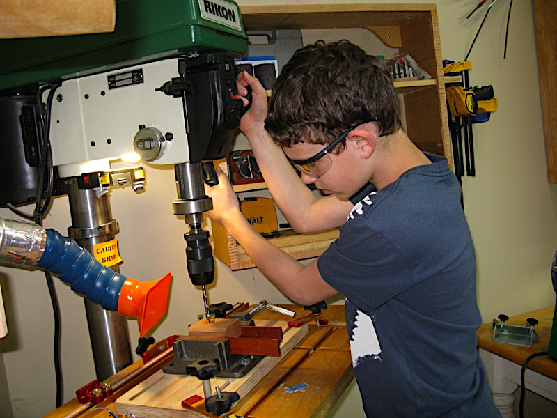

Filippo, does it handle 1/16" or smaller bits? Not that these are used too often on the press, but my Golden Goose will go down to a 1/32". I haven't tried smaller as the hand drill works quite well for that. I've often thought of a keyless for convenience, although a key sitting on a magnet near the chuck makes it pretty convenient.
Filippo Morelli wrote:
Bought mine at Woodcraft about 3 years ago. Probably the same one. I love it.
Filippo
