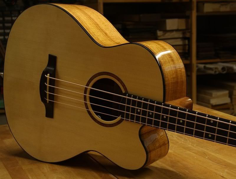

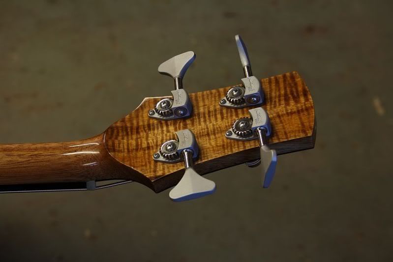

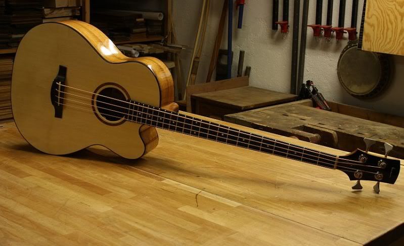

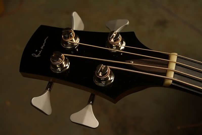

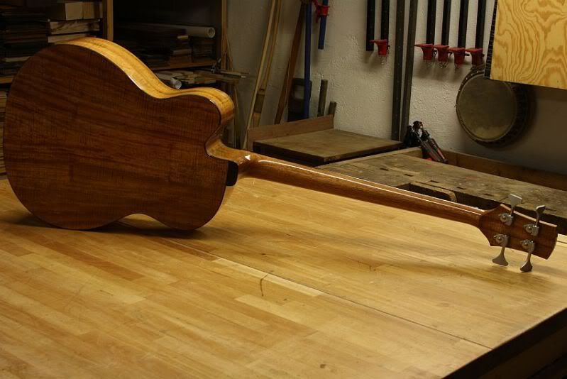

I posted a picture of this newly finished bass, and was asked to post some more pictures and details.
The top is Lutz, back and sides are Koa (thanks, Perer M!), mahogany neck, fibre binding, nitro finish. It sounds surprisingly nice, if I may say so! Thanks also to David Berkowitz, who was helpful in answering some questions I had about these beasts. I'm delivering it today, so no time for a proper photo session, but here are some snapshots from the shop.

I don't know if there are commercial plans available. I made one, based on my "SJ" guitar shape, with a 32" scale, joined then neck at the body at the 17th fret, and adusted things around that. I made the top quite flexible around the perimeter, but on the thick side in the middle, and it seems to give a nice, woody "ooomph"!

Sondre, its a pinless bridge (as per the customer's request), carved from a solid chunk of African Blackwood. The strings are go through it at an angle, and are anchored at its rear, where the string balls are half way hidden in a rabbet of sorts... It is also quite high, the bridge itself is 15 mm, and the strings are 18-19 mm over the soundboard at the saddle. There are no veneers or anything like that.

Very nice looking bass Arnt. The back of the headstock looks really nice on it. [:Y:]

The back is about 3,0 mm in the middle and up, down to 2,2 mm around the perimeter of the lower bout.
Arnt, thanks for that info! What I was trying to ask was whether the bridge is bolted to the top (as opposed to glued). I guess I was a bit unclear there... Again, it looks stunning!
