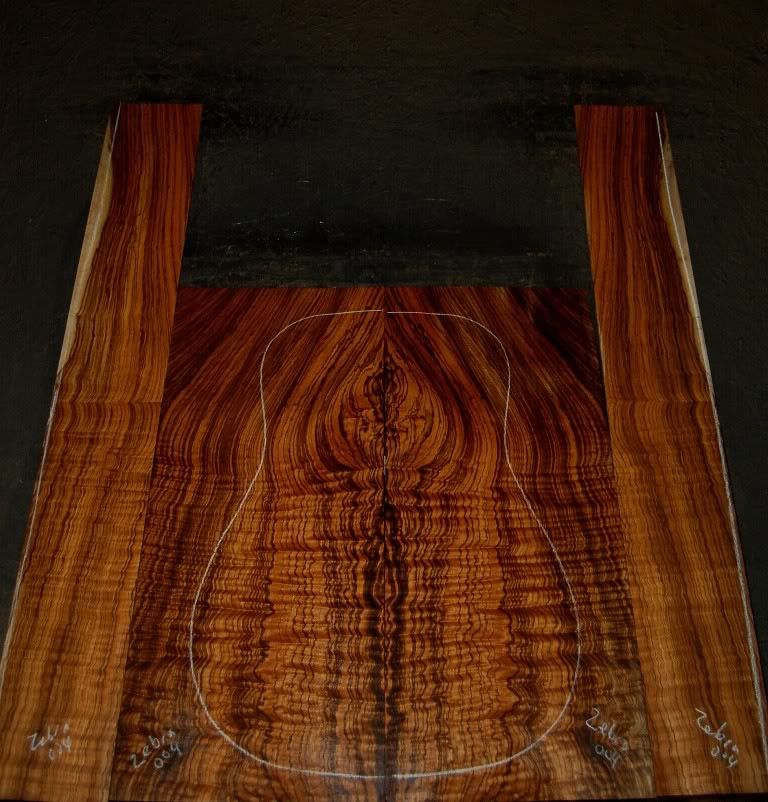

I have not used it yet but I have an amazing looking set in my stash from RCTonewoods.
For those who have built with it, what did you pair it with?
Neil
Neil
Wow - now that's a very interesting set. That'll make a very striking guitar.
